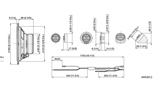

Just wanted to update the situation in the event someone replies. I have purchased a set of 2-way component speakers to replace the factory front door speakers & tweeters (Pioneer TS-A1607C A-Series 6.5" 2-Way Component Speaker System). 80 watts RMS. So, I should be set from a speak perspective. I'm not opposed to upgrading the rear 6.5s but have no intention to do so for the time being.
That leaves me with a decision about what to do with the amp. I could just install the new components and call it a day, but all my research compels me to upgrade the Bose amp. So, my new ask is for suggestions and guidance for an aftermarket amplifier to go with my Kenwood head unit and the new Pioneer components.

A two-channel amp will be fine, but if you get a bridgeable four-channel amp it can do fine also. Those speakers are wired together, probably with a capacitor as a high-pass filter on the tweeter. It doesn't appear they're made to be run on separate channels (active crossover), so while you could do it that way with a four-channel amp, they're configured to be just wired together to a single channel.
At 80w RMS each side, you'll have plenty of headroom even with a 100w RMS x2 amp. So long as you don't crank the gains up and don't crank the volume up, you're fine with "overpowering" your amp. I've always been happy with RF Punch and Prime amps, especially for the cost. R150X2 | 150W Full-Range 2-Channel Amplifier | Rockford Fosgate (sonicelectronix.com)
