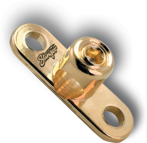

Since I'm using 4 gauge for the grounding wire, would it be advisable to use one of these? It fits 1/0 gauge, and I should be able to squeeze (2) 4-gauge wires in there.

That's gold and says Stinger on it.
Those are the two reasons I wouldn't use it. But the electrons don't care.

Is platinum plating better than gold?
