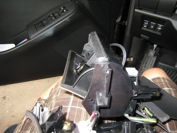

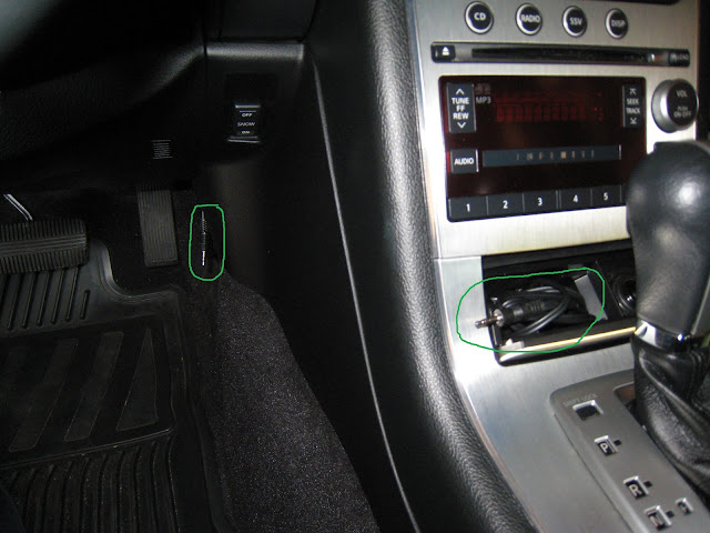

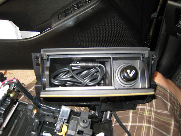

Did my PAC-AAI-NIS2 today. Reading all the threads, I didn't see anyone putting it INSIDE the cigarette lighter / coin box. I was able to get one of the aux line into that coin box without drilling a hole and it's all stealth looking when I close the cig/coin box.
How did you get it through the coin pocket?
Old Jul 24, 2009 | 10:41 PM
  #98
mikeee2's Avatar
Joined: Aug 2004
Posts: 1,707
From: New York
First, remove the coin box insert inside the coin box. It's a container inside a container. Once you take that out, you'll see a tab and a small opening. The tab is flexible and thus that's how the wire comes out from the inside. Then separate the coin box from the shifter console. There's a metal plate in back of the coin box. Remove the metal plate and you will be able to pull a wire through the coin box.
