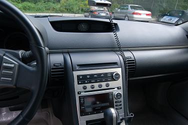

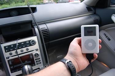

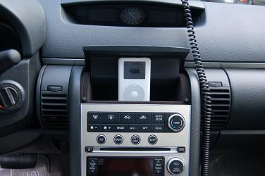

Thanks bradakrez. This thread was perfect. Installed my IPOD USA Spec PA11-NIS today. Took a little over an hour and I did not even break or scratch anything doing it. I drilled a hole large enough to fit the IPOD cord thru the base of the top compartment of the center console. The IPOD attaches to the inside of the top lid when open, can be pulled all the way over to the passenger seat with ease, and when attached looks like it is mounted there. Incredilble addition to a near perfect ride. ( I know I need a newer IPOD)
