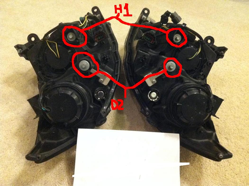

This is on my to do list since I lowered my G coupe ive noticed the light is to close to the front bumper.
any have pics on the actual screw for the 06 projectors
thanks

Finally adjust the headlight.
You have to turn the 8mm hex screw counter clockwise

which way u turn will depend if u need to go up or down. cant jus say "You have to turn the 8mm hex screw counter clockwise "
Correct.........
counter clock wise for UP
clock wise for DOWN

From: QUEENS, NY
Picture updated
Sorry but the picture was taken with the headlight upside down from another member.
The red circle are 8mm. in which u need to turn clockwise for down ...and counter clockwise for up
