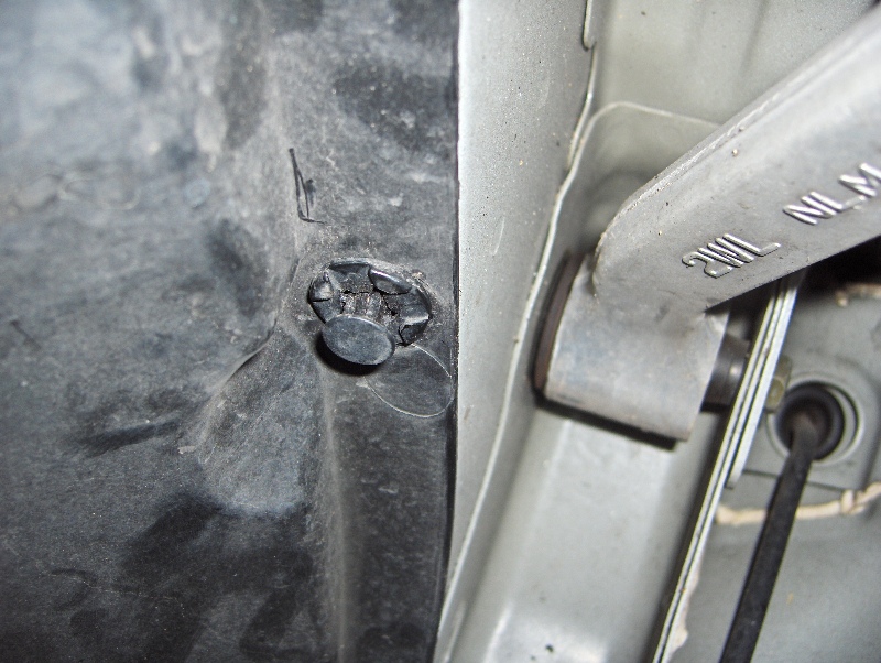

Step 2.
Use the stubby flat head to take out the 3 clips on the inner fender liner.
DIY: Replacing Fog Lights-fog-light-install-1.jpgDIY: Replacing Fog Lights-fog-light-install_001.jpg
This is the clip directly below the upper control arm.
Proceed to take out the other two clips, one directly above the tire and the other one is about a foot below the first one.

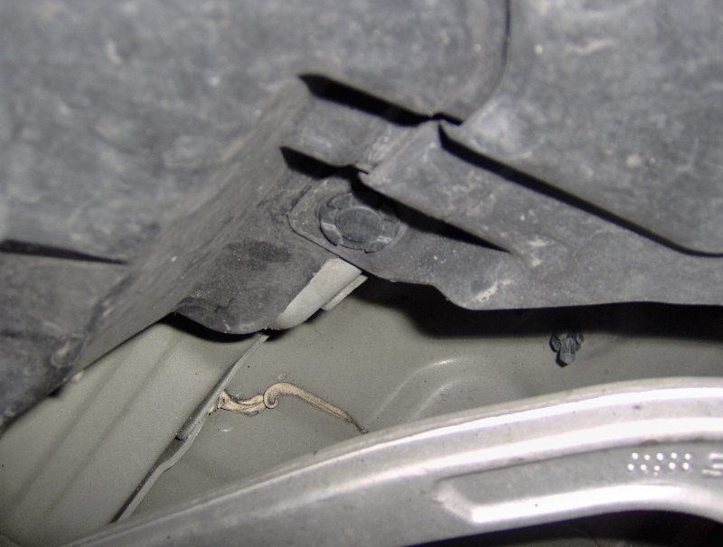

Step 3.
Remove the screw above the corner light with your philips stubby
DIY: Replacing Fog Lights-fog-light-install-4.jpg

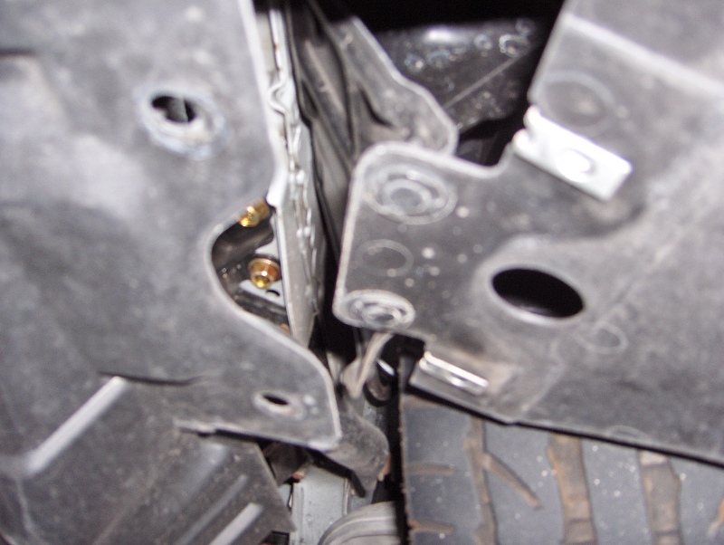

Step 4.
Get under the car and remove the 5 10mm bolts with your 10mm socket or adjustable wrench (you can do it with a philips but they might be too tight so i loosened them with the wrench then took them out with the philips.
DIY: Replacing Fog Lights-fog-light-install_002.jpgDIY: Replacing Fog Lights-fog-light-install_003.jpg

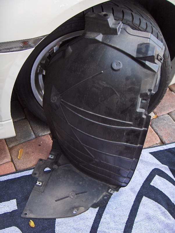

Step 5.
Once all 5 bolts are out pull the fender out from the wheel well like so.
DIY: Replacing Fog Lights-fog-light-install_006.jpg
Step 6.
Go back under the car and take out the remaining 2 clips that hold the fender in the wheel well. then pull the fender liner out all the way.
DIY: Replacing Fog Lights-fog-light-install_007.jpgDIY: Replacing Fog Lights-fog-light-install_008.jpg

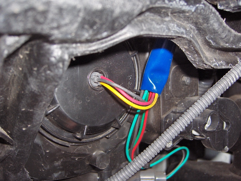

Step 8.
Pull out the connector from the bulb itself (Shouldnt take that much pulling, but dont be afraid to give it a little muscle, you wont break it.)
DIY: Replacing Fog Lights-fog-light-install_011.jpgDIY: Replacing Fog Lights-fog-light-install_012.jpg

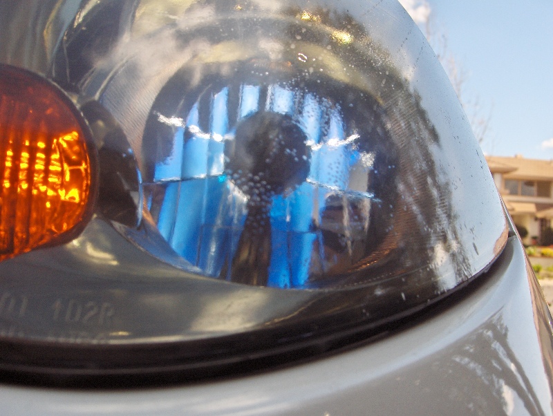

The particular bulbs i used are Luminics H4 6000K Pure Blue fog lights.
Here's what they look like after being installed.
DIY: Replacing Fog Lights-fog-light-install_018.jpgDIY: Replacing Fog Lights-fog-light-install_020.jpgDIY: Replacing Fog Lights-fog-light-install_021.jpg
If you have any questions at all or you need pictures with arrows or something feel free to ask. Hopefully this will help a couple people out that dont know what they're doing. This took all of 30 mins with snapping the pictures in between. So it would only take about 10-15 mins each side if you follow the directions and dont run into any problems.

damn! i've never heard of Luminics H4 6000K - i just got PIAA Super Plasma GT-X 5000k, thinking that it's the bluest one could get in non-HID. how are they at night? do they have high-beams, and if so, what's the temperature of those? do you have any night pics? /me subscribing

They are good at night, pretty bright down low, they have high beams but they're not very good (i used to have the luminics 3750K ultra golden bulbs and the highs on those were awesome, they lit up everything), they light up signs very well though. dont know the temp of the high's. I dont have any night pics, i tried taking some but they didnt come out right (i dont know how to take good night pics)
