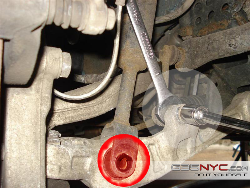

I'm having problems with this bolt. I'm at the point of stripping it. I used a 17mm socket and breaker bar. I even sprayed that PB rust removing lubricant spray.. help!

i know u have to wiggle it out. that one is difficult. try tapping it with a rubber mallet.
