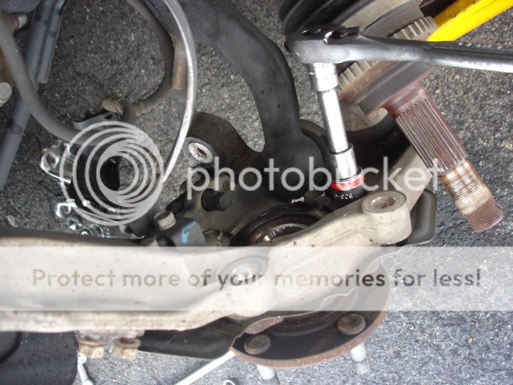

Now at this point, you have access to the 4 bearing bolts. They are 17mm. You can remove 3 of them completely at this point, but one is positioned behind the compression rod and cannot be completely removed. You might have a tough time getting at the bolt. If you are planning on removing the spindle like i did here, you can just leave it and unbolt all 4 (or the 1) once the spindle is removed, otherwise if you are feeling brave, or have a low-mileage or southern car, you can loosen the bottom bolt as much as possible, then reassembly the upper control arm link and bang away with a slide hammer....choice is up to you here
You can see the issue with the bottom bolt here hitting the compression rod.
