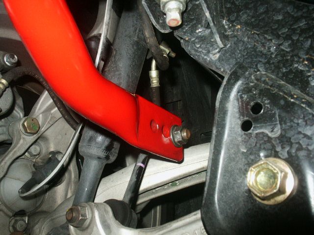

In order to make rear sway bar little stiffer did anyone tried drilling additional bolt holes? Please share your experience, does flat portion of bar have enough room for additional hole or did you have to press it first? I like to increase rate of my rear sway bar by 10-20%. Thanks

See I have been waiting, for a while now, on 350evo rear bar to be in stock.
I am OK with my current suspension, revised 350Z springs and front bar with Tokico D-Specs, it’s just that at high speeds front is starting to plow in curve. Perhaps slightly stiffer rear bar wont make a difference for my understeer if my front tires are already at limit, BUT, I have this spare (350Z) OEM rear bar and looking at Stillen pictures made me thinking.
Rear sway bar rate:
OEM 385
350evo 378, 490, 607
Stillen 412, 581, 654
https://g35driver.com/forums/attachm...1&d=1149111407
Attached Thumbnails Stock rear sway bar, anyone drilled additional holes?-rear-sway-bar-stillen.jpg

Looking at the oem rear bar I have off the car in my garage, it looks like one could drill another hole. However, I'm not sure you'd be able to have enough room to seat the nut/washers on the bolts and have moved back enough to have really effected the lever arm distance.

Gsedan35, thank you very much for reply, you are absolutely correct that there would be no enough room for the bolt nut/washers on the bar without pressing it first.
