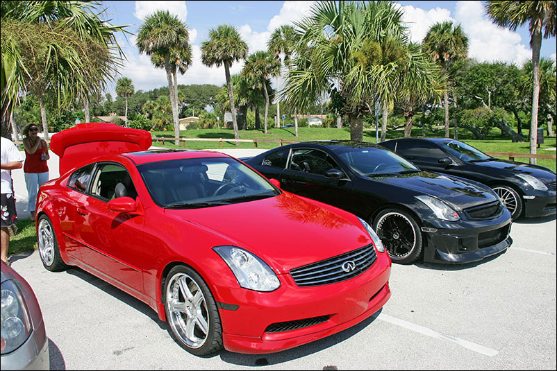

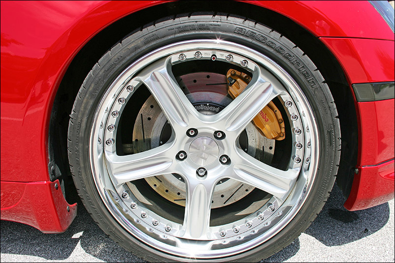

A couple of pics of the look after installation.
Attached Thumbnails SPC front camber delivery extended!!-front-wheel-1.jpg   SPC front camber delivery extended!!-front-wheel-2.jpg
Old Sep 12, 2006 | 01:48 PM
  #45
kenchan's Avatar
Joined: Aug 2004
Posts: 4,288
^^ definitely needs more neg camber on the front.
