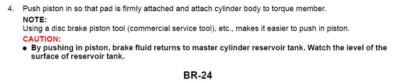

Whenever you push the piston in the caliper in you are supposed to open the bleed valve and let the pressure get relieved there. You can damage the whole ABS system if you dont do this. I've seen it a lot were it damages the ABS modlule and can damage the Brake booster.
It will not damage the system by not opening the bleed valve. The Infiniti Service Manuals does not say to open the bleed valves when doing this, and even says the fluid will return to the master cylinder when compressing the pistons. If the ABS modules or the booster breaks when doing this, then you can take it to Infiniti and have it replaced under warranty, because following the Service Manual's direction is the correct procedure as far as Infiniti is concerned.
I went through the same thing with Acura when they tried to deny a warranty repair on my transmission, over flushing procedures. I asked the service manager to show me in the Acura Service Manuals, where the flushing procedures differed from the way I performed it. They re-instated my warranty.
