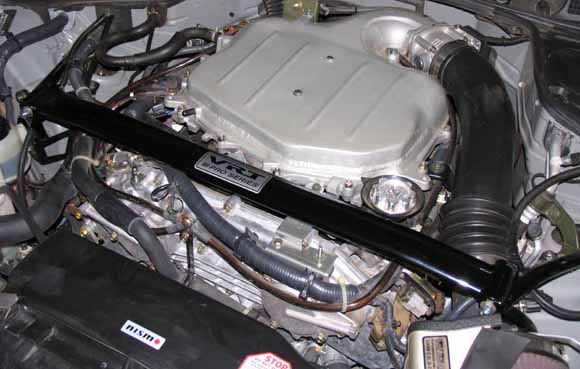

Why not just put on the VRT STB and have the best of all worlds? It really is a great STB
Lou
