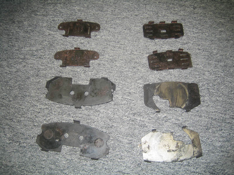

The the brake spray are like the brake cleaners just spray on to the surface of the rotor? and the brake pad shims are you talking these? see attach picture!! I didnt put these on, are they suppose to be place back onto the brake pads?

Yup those are shims...they'll help...

So i should put these shim back? also should be apply anti squeal compound on both side of the shim? and type of anti squeal compound works the best?

The shims are supposed to go back onto the new pads. Use some antisqueak compound. I've been using some CRC anti squeal spray (it's like glue) with good success.
