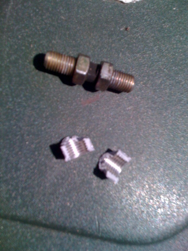

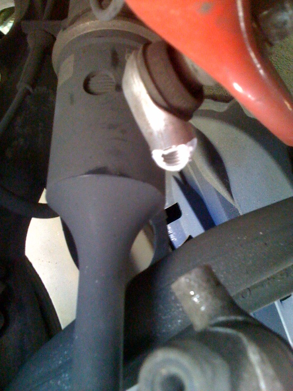

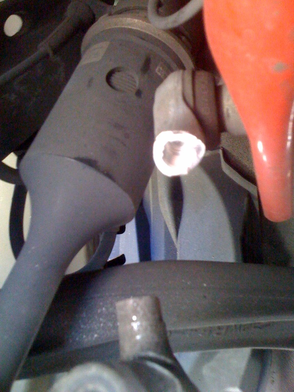

So went under to adjust the end links a bit, since the car got raised a bit and I wanted to make the bar more parallel to the ground when in normal position. Put the wrenches on to loosen the end link and pow... I got the PowerGrids and never touched them after installing them and having them professionally adjusted/checked soon after.
I hope I can get a replacement. And to all others: careful with these, apparently they can be a little fragile.
