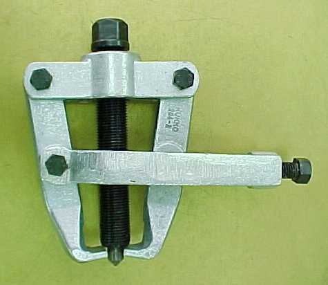

How do you remove seat from the stock ball joint on the OEM control arms?
I'm trying to install my SPC front camber arms, and I need this seat.

I found my answer, but if anybody knows a easier way, pls post
http://www.my350z.com/forum/showthre...+front+install

I just bought new lower ball joint seats. They are like 10 bucks each.
Nissan part number: 40173-AL500

I think the ball joints are press to the upper control arms
+1 thats what I did. Much easier than trying to get the old ball joint seats out from the upper control arms.
I did the same and updated my DIY thread to indicate that. Just plan ahead because my Nissan dealer didn't have them in stock and it took 3 days to get them in. The Infiniti parts guy was a moron ans said I couldn't buy them separately and that they were on the a-arm only.
They are but I got them off using a small two arm gear puller. Price FREE .
