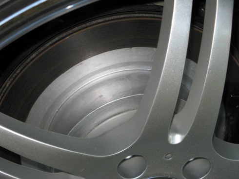

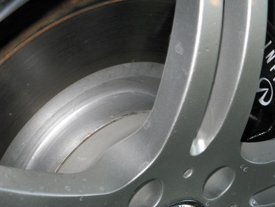

Here are 2 pictures of my painted OEM roters....The silver bands around the face was rusted before I painted it.

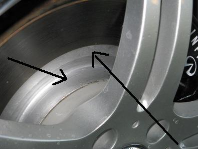

Ok my rotors are rusted and they are OEM as I am the first owner of the car.
I have attached a picture that indicates where I have rust.
Picture taken from caltender to indicate where I have rust.
Attachment 97835
Attachment 97836
I guess you just painted the entire rotor fron and back and once the pads swept the rotor it cleaned it off. Is that safe to have paint being swept by the pads? Hmmmm kinda dumb question I guess cause you already done it.
Old Nov 7, 2008 | 12:34 PM
  #49
caltender's Avatar
Joined: Jul 2007
Posts: 455
From: SoCal 714
I didnt actually paint the whole rotors...No
I used a brush and was extremely careful when painting......There was very liitle paint where the pads swept the rotors when I was done ...and yes it wore off with the first touch of the brakes.....
