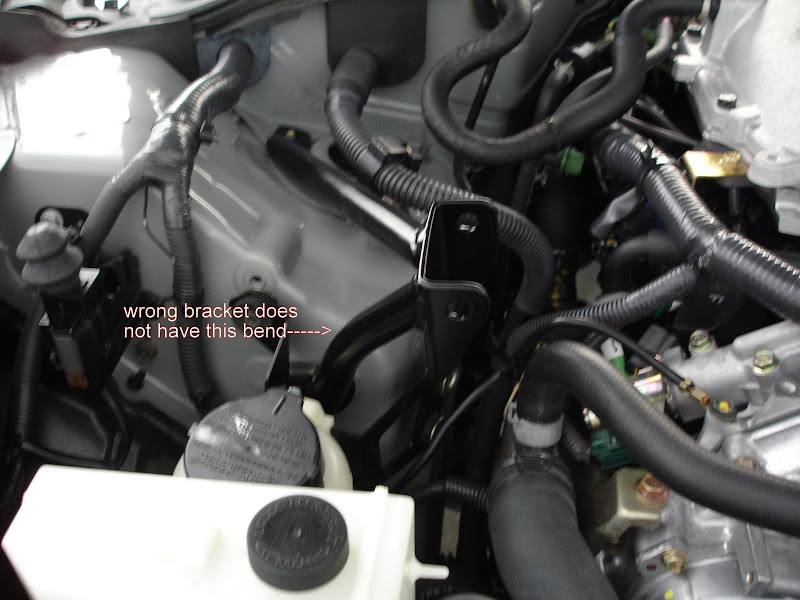

Originally Posted by viceversa
the wrong bracket is the one where all 3 attach point bars are straight with no bends in them. The right bracket has a slight bend in the bar which attaches to the control arm bolt.
Bar is on, fit with no problems and rides very nice. feeling really lazy right now, pictures tomorrow.

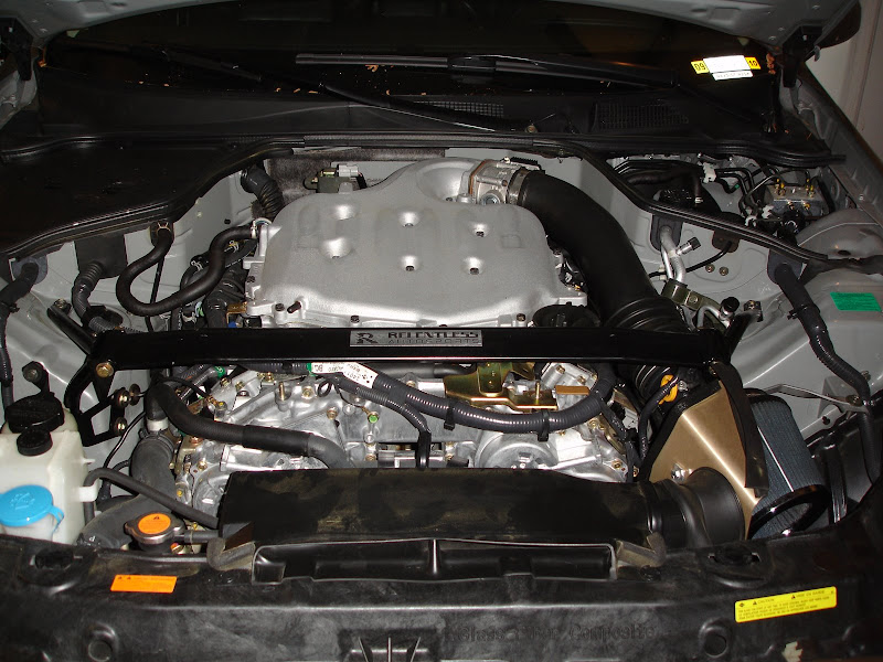

The following picture has the bracket for a turbo on the left and the corrected N/A bracket on the right:

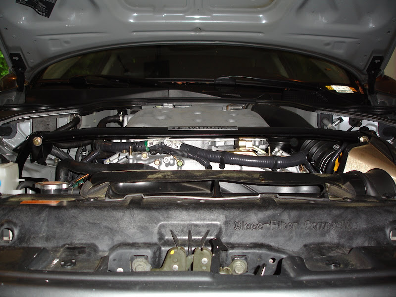

This picture shows the corrected bracket installed showing a bend in one of the bars which was not in the first bracket i received which caused my hood to rub.
The easiest way to drop the strut down so you can put the bracket on. NOTE: both sides of the car must be off the ground to make it easy for the sway bar bolt to come out. Line a floor jack up like so and put just enough pressure upward and you should be able to pull the bolt right out. You can then push down on the whole assembly and place the bracket on.
Finshed product, please excuse all the damn pollen
