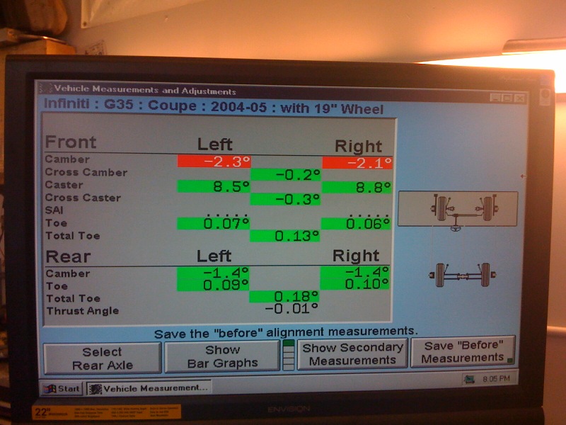

just installed spc-rear camber kit/toe bolt and got alignment, how are my specs?
Finally got my spc rear camber kit installed with the toe bolts. Got it aligned right afterwards too. Car is dropped on g35 tein s-techs. Can you guys let me know if my specs are okay?
I know the s-techs are suppose to lower the front 1.2" and rear 0.9".

Looks like you need a front kit. You're way out of spec there.

Its not that bad I would have like to see the toe a bit better but, its not bad

I had the same problem as you, my camber settings were out about -1.9 degrees before the installation of the front arms, this is with Eibach prokit.My friend who was doing the alignment recomended I should get the front kit. I ordered it from THmotorsport and I dealt with Eddie amazing guy after I paid for overnight shipping he got the part out of his warehouse that same evening after hours as well, anyway here is the data sheet:
Btw this is with both rear and front alignment kits.

Nyckid, did u have to elongate the toe bolt area to get your rear camber down to -1.5 on both sides.?
