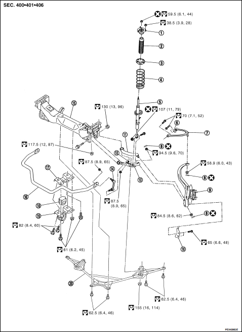

28 ft-lbs on a 2005 coupe (see attached). i'd assume its the same for your model year.

Thanks a lot . Too bad I only have an in-lb torque wrench, guess ill have to go buy a ft-lb one lol.

you can get to foot pounds by multiplying by 12. most of the in-lb torque wrenches i've seen go up to 240 in-lbs (20 ft-lbs), so max that out then hand tighten it a bit more.
honestly, you can tighten these bolts without a torque wrench. just don't go crazy and you'll be fine.

Yeah I thought about using my in-lb wrench, but I think it only goes up to 120 in-lbs....I can just borrow one from my buddy though.
I just kept thinking of the people who snapped the bolts while installing their plenum spacers without a torque wrench haha. But you're right, I shouldn't have a problem with these bolts.
