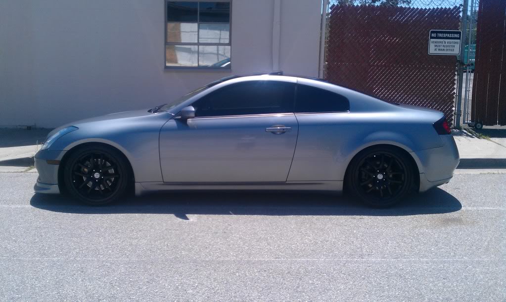

Eibach prokits and eibach rear camber kit, had them on for about 4 months now and loving them. And yes i know i need spacers! Also no specs but will be a little negative i think.

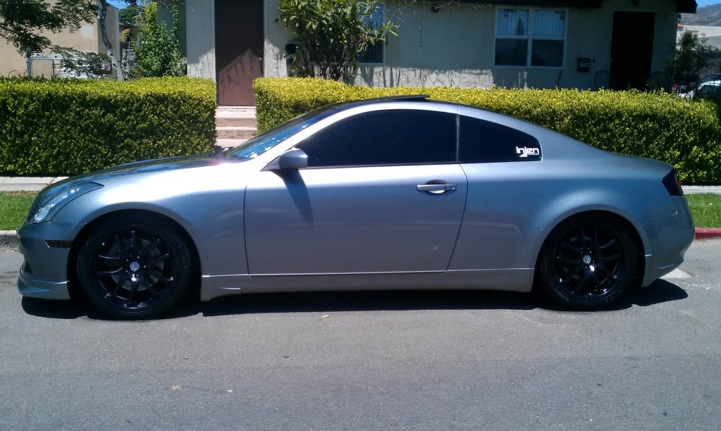

Here's another !

Do you have the G35 or 350z prokit? Any mount for the springs?

G35 kit, and have no idea what the mount for the springs is. Can you please explain what that is and its purpose, thanks!

Is a rubber mount that holds the top of the rear springs. Some people including me when I had my coupe will cut it so you can lower the back a little more with springs. I had 350z's pro-kit on mine and the rear was higher than the front so I cut it 1/2 an inch and got a even drop.

is it just me or does it look like you have a reverse rake...front higher than back. did you buy car used? wonder if someone modded spring mount. back looks really low for either G or Z Prokit. possibly big stereo in the trunk?

^^agreed...that stance looks messed up...rear looks quite a bit lower than the front for some reason..id say the rear mount was either left out or cut too much?

Yes OEM 19's, but no spacers. My wheels are sunked in and I definitely need spacers.

Hmm, it might be the ten inch subwoofer, amp, spare wheel, jack, and cleaning supplies?? I haven't checked to see if taking all that sh_t out would make a difference. I'll try and let you guys know.
