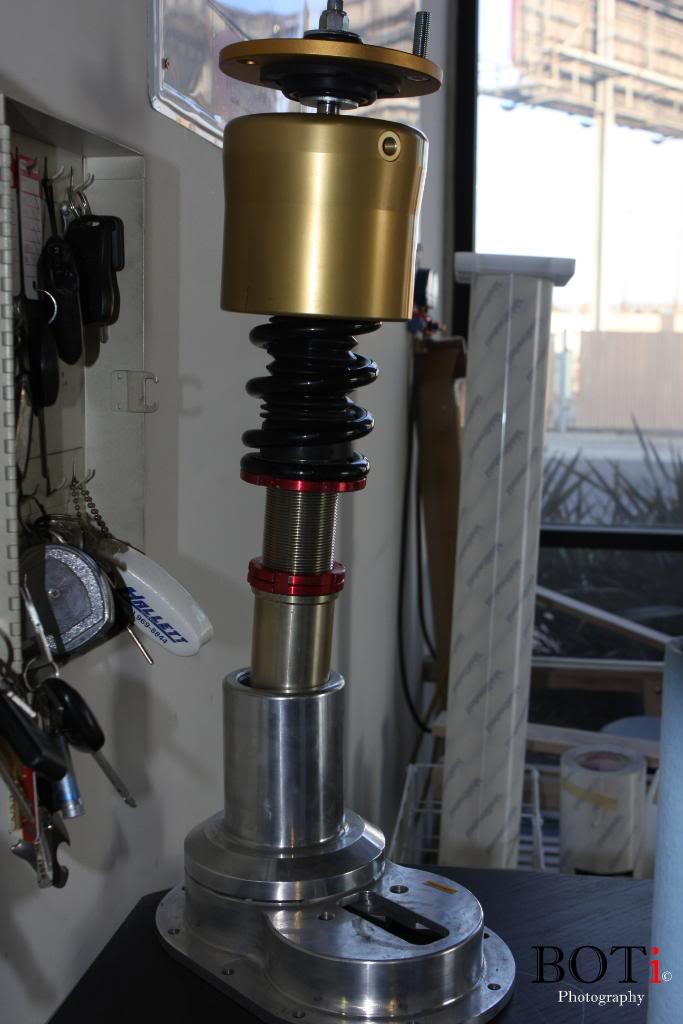

Cup kit looks like this:
Basically it's a little air bag that goes over the coilover to raise it, I believe about 2-3". When little bags are deflated you are using 100% coilovers. You can drive with them up but the purpose is to drive with it down, basically on your coilovers. You have to make sure you get a coilover that will fit it and one that will give you the height you need. The cost is less, especially install cost.
