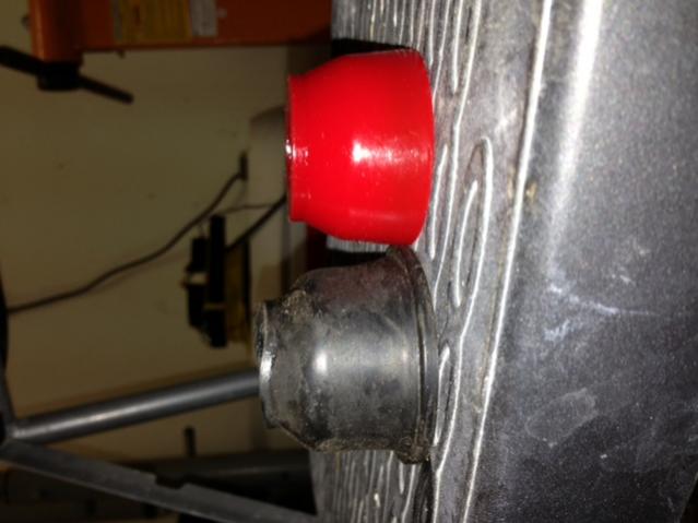

I've had them for quite some time with the ES boots and honestly I haven't looked back since.
with many ... many miles put on them and some even tracked.
I ordered these and was going to install them, but the ES boots recommended seem shorter than the boots that came with the ball joints from Auto Zone. Did you have that issue?

ES boots are shorter but haven't had any issues. Only have had them on for 2-3k miles. Did notice they didn't have that muffin top like the oem style. Nothing leaking so I'm happy. Fitment looks perfect once installed.
You used the ES 9.13130 ones, correct? Idk, they just looked maybe half an inch shorter, so I thought maybe I got the wrong ones. I guess I'll attempt swapping those in. Thanks for the feedback.

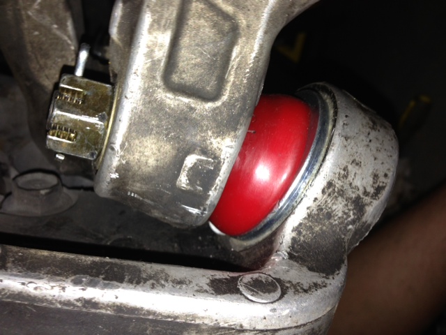

that's the part number I used. This is how they look when all torqued down.
Attached Thumbnails Front lower ball joint boots-ballj.jpg   Front lower ball joint boots-balljj.jpg   Front lower ball joint boots-balljjj.jpg

So I did mine yesterday, and the old ones still had some life left in em according to the mechanic. My mechanic wasn't too crazy about the Auto Zone ball joints, even though I used ES boots with them. He told me I should've looked for Moog brand ball joints instead. Which I don't even know if Moog makes these for our cars. Overall, it was annoying to get the old ones out, but everything was easier thereafter. Thanks for the assistance guys.

correct
and that's how it'll look!
