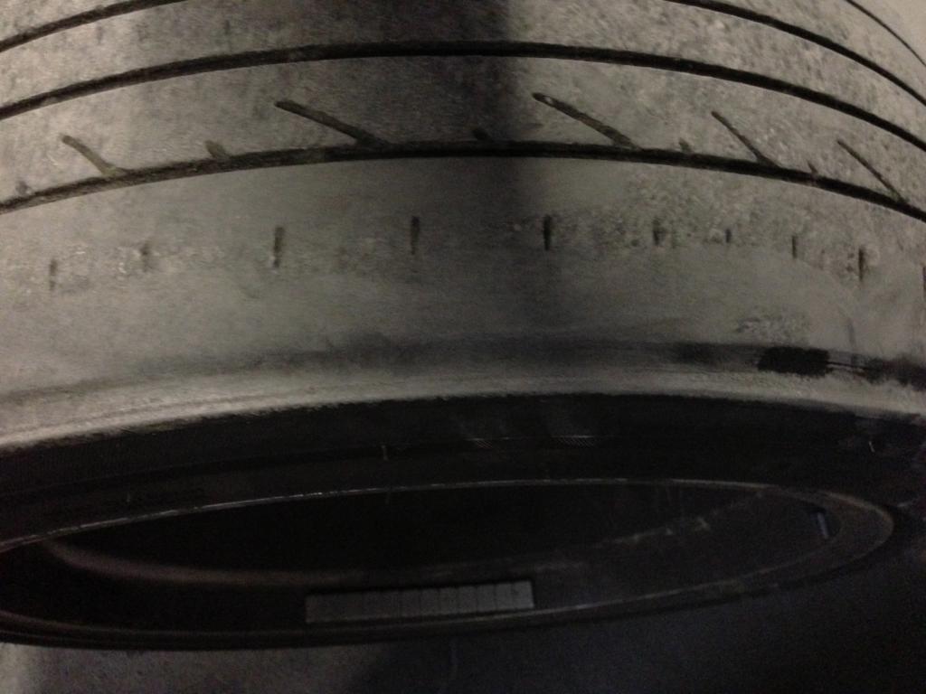

Yea it could be the ball joint

Looks like toe wear to me. Need a new alignment.

thanks on the input guys! ill go get a new alignment and post the numbers

I suggest not to. Not until you check your bushings, otherwise that time is going to waste. Trust me, if it for any reason is a worn out bushing it will wear out like that. I speak from prior experience. If however everything is in good condition, then get the alignment.

alright.. which bushing should i specifically look at?

Mine specifically was the lower control arm. I'd have anything that would affect your alignment checked out.

Bad LCA bushings are easy to spot. Just put the car up on stands and look at it. it should be centered.
If not it's bad. Next try to move it. I could move mine, it was obviously shot.
KP

Originally Posted by DaGdriver
Im on stock suspension and only one centimeter of the inner tire gets eaten up the most. any ideas. I got alignment done about 3 months ago.
I'm getting the same thing...although its not as bad as your yet. When I took my car to the dealer for service, the technician said my compression rod bushings were worn and thats what was causing that type of uneven wear on my tires.
Attached Thumbnails what is wrong with my suspension-img_3737_zpsb82e828b.jpg
