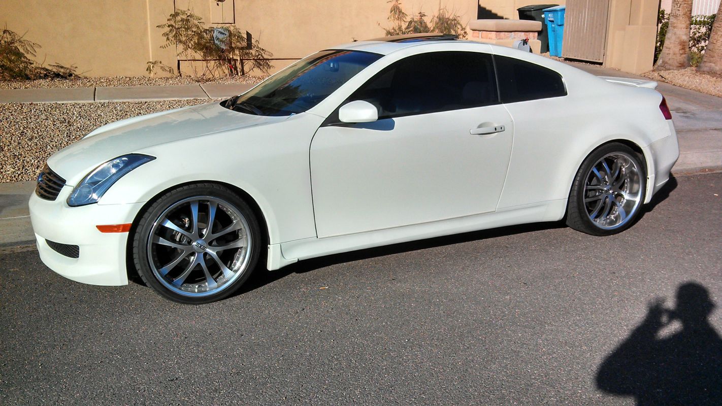

here is a pic of the car.....

It actually looks good as is. If you ask me, I would get springs that lower less than an inch so you won't have to spend money on camber kits. I have nismo springs in the market place if you're interested.
