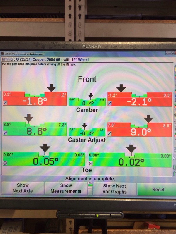

So I purchased the rear camber SPC kit, am I going to need the front kit in order to pair up KYB's with the eibach prokit? Or will the front tires be alright ?
Old Mar 4, 2014 | 08:29 PM
Shawno72's Avatar
Joined: Oct 2013
Posts: 1,254
Likes: 78
From: Cali
Well I just installed a set of swift springs 1" front and 1.1" rear with spring mount mod. I also installed the spc rear camber arms and toe bolt kits. Here is my alignment results. Like I said I just did this last weekend but so far tires are wearing fine

Nice man!!! Thanks, gives me confidence in my setup. I bought the eibach prokit which is the same drop.
