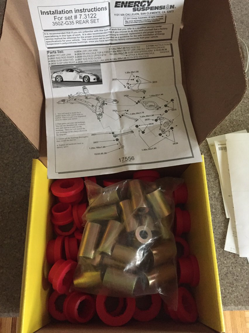

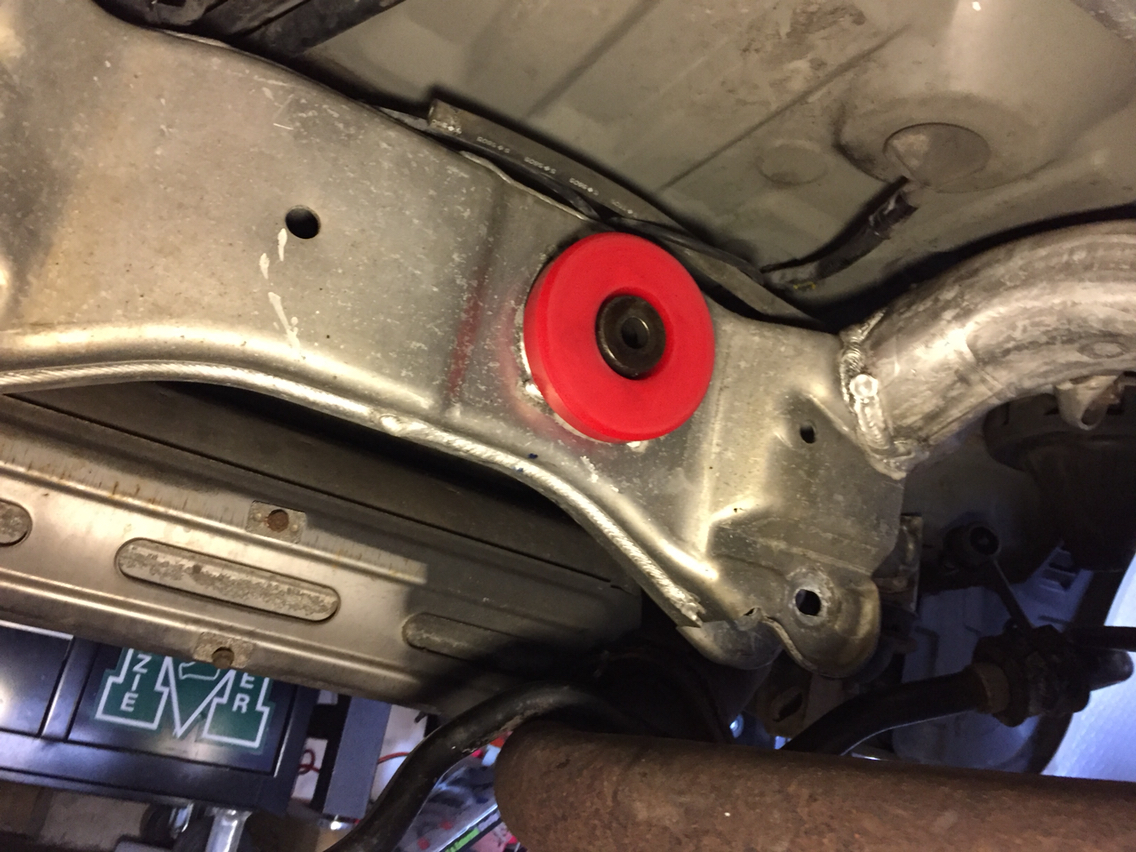

If the knuckle is worn like that, you have caster? issues man. The whole knuckle was likely dancing around in there over every minor road imperfection.
Time to order the energy suspension rear bushing kit and swap everything. Would highly recommend a CAMBER KIT, but you don’t necessarily NEED one. Would also recommend the diff bushing kit from energy. It MUST BE the revised one. The old one slips out like a wet noodle.

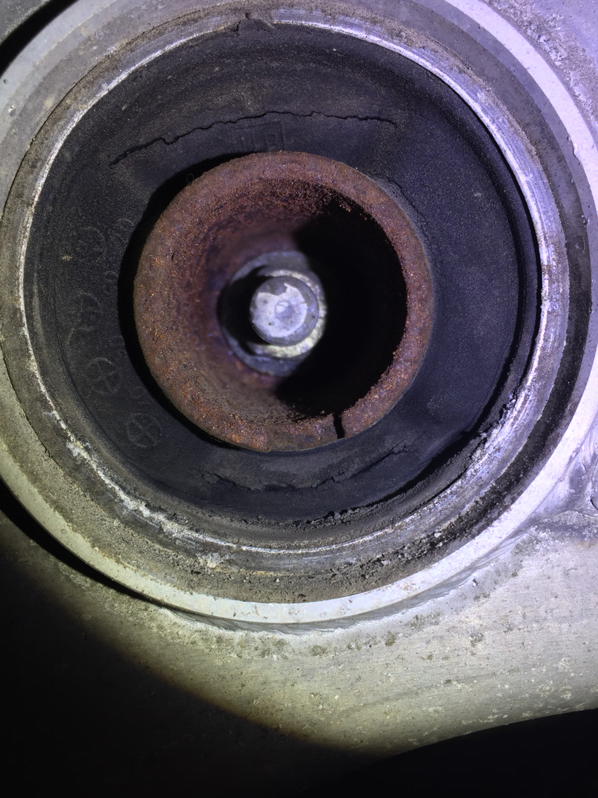

It's most definitely gonna be either the bushing in your spring bucket or the bushing in the control arm. They don't always have to "look" broken. Hell, even if it's slightly worn and you put your toe into spec on the rack, once you drive it out of the parking lot, a worn bushing can shift your camber enough to screw up your toe. This is why the comp rods bushings were screwing up everyone's tires. Once they wore slightly, the suspension couldn't hold the proper geometry.

Found this, if you decide to do the upgrades: https://my350z.com/forum/engine-driv...ml#post8564405
