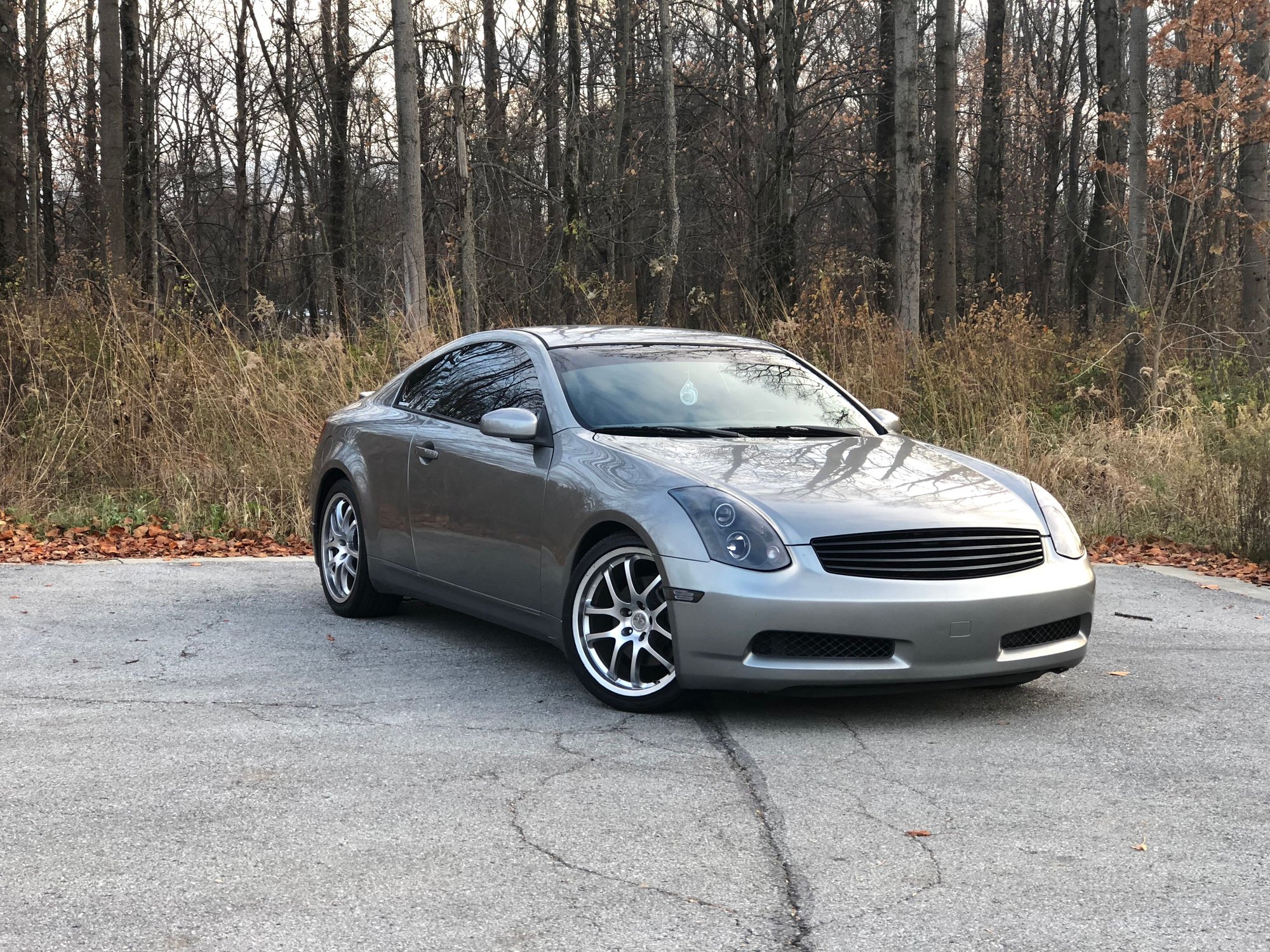

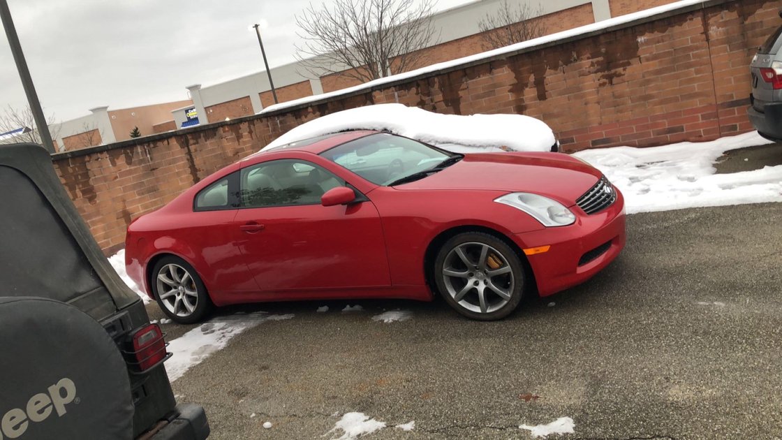

So I have a situation which I couldn’t really find if anyone else has done before. I have a 2005 Coupe (HR Swap, 75k Miles) which I’ve had for about 2 years now and I love it. However I recently purchased another 2003 6MT Coupe for a great deal (mainly to clean up/sell and make a few dollars on). But the 03 has the Brembos as my 05 doesn’t (has stock brakes) and I’d love to swap the brakes between the 2 so I get a nearly $1500 “upgrade” to my 05 for basically free while still leaving the 03 functional to sell with my stock 05 brakes. The 03 is a 6MT with the E-Brake in the center while my 05 has a AT and has the foot E-Brake and I wasn’t sure if I could just swap the brakes from the 2 with no E-Brake issues or dash ABS lights or anything on either car. Just curious if anyone knew or had any tips.

No issues, common swap. Calipers, rotors, brake lines, brake pads.
I would completely flush the fluid as well. Nonstandard bleed order so read the FSM on that.
