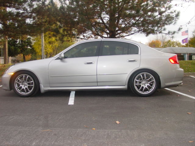

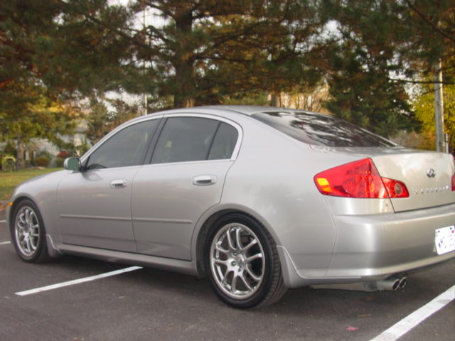

As you guys know, I recently dropped my '05 Sedan on 350z H-Techs (pix below). I'm now working on getting just the right setup with my adjustable D-Specs and Sways, while also experimenting with the alignment.
Initially, since the front dropped .5" more than the rear, there was more negative camber up front, and the rear was coming loose very easily. But since I have no front camber adjustment I had them add enough negative camber in back (-2.12) to give it some teeth during cornering. While this adjustment accomplished that goal, I now notice that the ride quality has notably deteriorated. It's not horrible, but feels much rougher than before adjusting rear camber.
I know there are always tradeoffs, but could I expect better ride quality if I get a front camber kit and add back some positive camber to both the front and the rear? Is it possible to have the best of both worlds? Ultimately, I'll trade a little ride quality for great handling if I have to, but would love to have a smooth-but-firm riding, awesome handling G.
What's the formula?
-T
PS FYI, to complete the picture the D-Specs are set at 3.5/4 (f/r) from full hard. The sways are soft/medium (f/r).
Attached Thumbnails Camber and ride quality-pd-rear-left.jpg   Camber and ride quality-pd-left-side.jpg

car looks good. you're okay at -2.2 camber on the rear.
