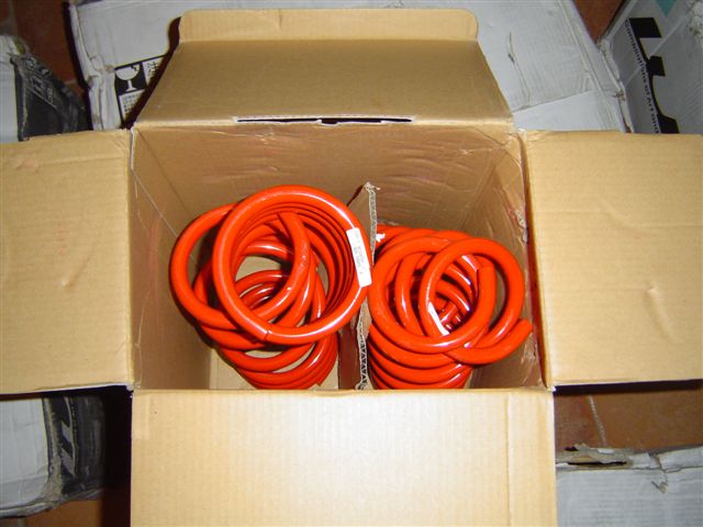

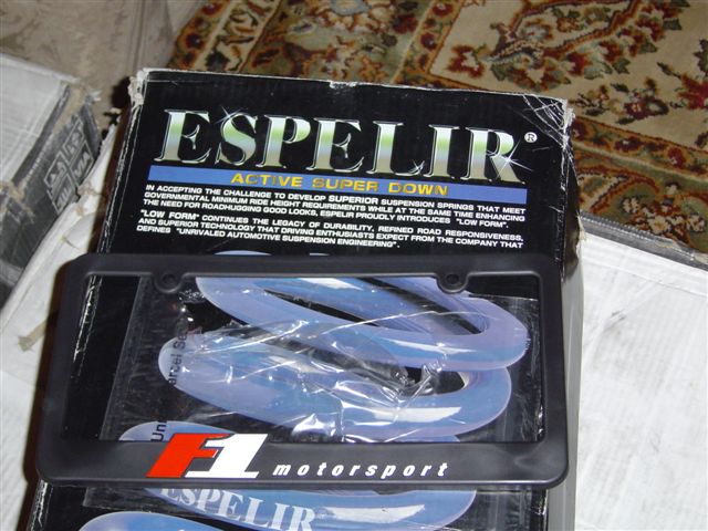

I just got these delivered and am having them installed tomorrow.
I will let ya know my impressions and I'll take pics to show the drop. I am not going to go too low as I am getting the KurumaZ bumper.
I bought them from Chris at F1 Motorsports for less $$ than on this site but here is info on them.
http://store.yahoo.com/hopup1/esni3503gtra.html
Attached Thumbnails What springs to get on my Coupe?-dsc01364.jpg   What springs to get on my Coupe?-dsc01344.jpg

Ok, so in inches what does 10mm equal?
Old Feb 2, 2006 | 12:37 AM
Triji's Avatar
Joined: Nov 2003
Posts: 3,126
From: The Valley, AZ
Um yeah.... about [______] that much!??!
I think it is about between 1/2 & 3/4 of an inch.
Here is a thread on them.
https://g35driver.com/forums/brakes-suspension/71144-lowered-w-espelir-springs.html
