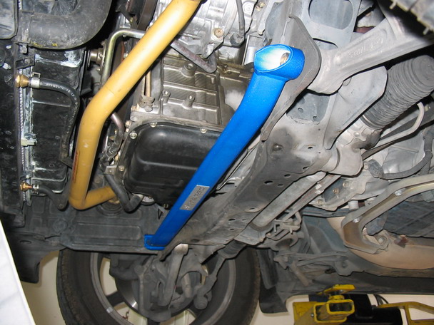

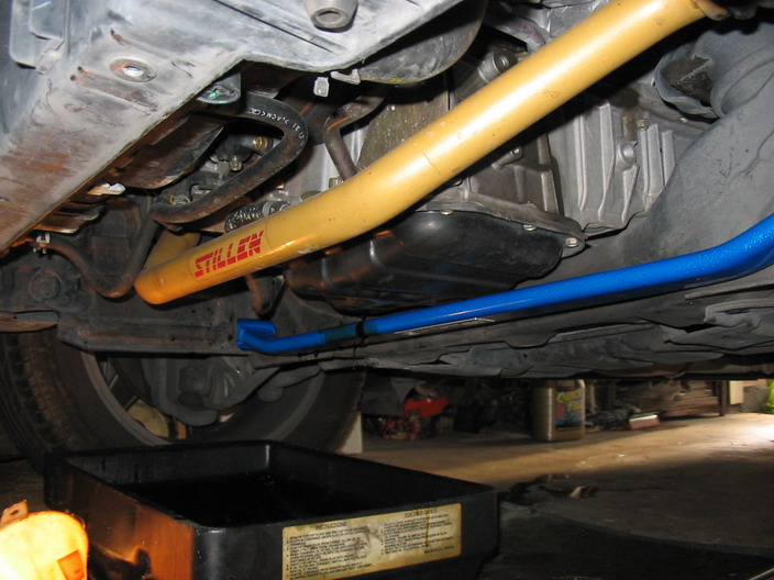

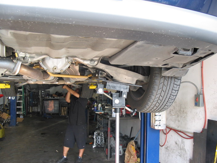

How easy of an install is this? I just got mine yesterday and thinking about installing myself.
Old Jun 6, 2006 | 01:04 PM
  #23
cato's Avatar
SouthernComfort Moderator
Joined: May 2003
Posts: 3,653
From: Sugar Land,Texas
Originally Posted by dream_G35
is it a very very tight fit or will it fit just right....
The stock bushings work perfectly, don't let anyone tell you differently.
Attached Thumbnails stillen sway pic-117_1751_resized.jpg   stillen sway pic-117_1765_2_resized.jpg   stillen sway pic-117_1773_resized.jpg
