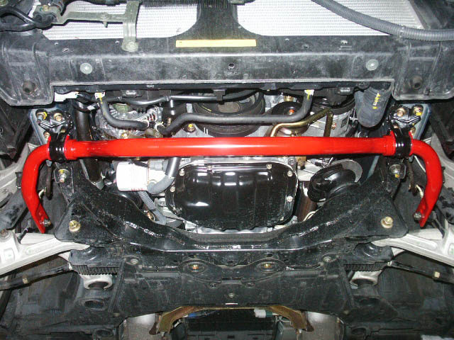

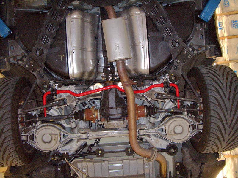

Old May 1, 2006 | 06:08 PM
Brando's Avatar
Joined: Apr 2004
Posts: 1,860
From: GA
Thumbs up
Here's one of mine.....one of the best mods I did!
Very easy install.
Attached Thumbnails stillen sway pic-ag-tb-rackfsway.jpg   stillen sway pic-ag-tb-rack-rsway.jpg

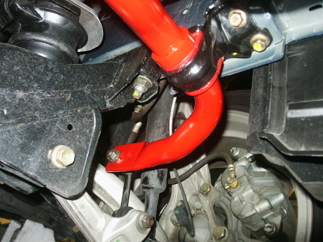

I have my stock sways stored but they do seem to get in the way. The only reason for keeping them is if I part my mods out when I buy a new car.
On the subject of Stillen sways, best mod I have done so far. I did get energy suspension poly bushings too. I ended up having to go back to stock bushings in the front due to little bit of play. I recommend just getting the rear poly bushings an staying stock up front. The best part of the Stillens is that I didn't have to buy collars separately, they have theirs welded on.
Dan
Attached Thumbnails stillen sway pic-sway-bar-install-022.jpg   stillen sway pic-sway-bar-install-024.jpg   stillen sway pic-sway-bar-install-026.jpg
