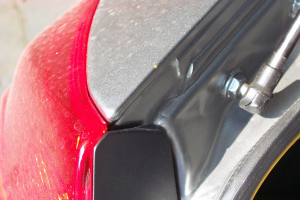

I have one too. Don't know how it could chip there. Gotta be careful with that luggage I suppose.
Yes. The car is unclean at the moment.
picus, thank's for the advice. Much appreciated.
