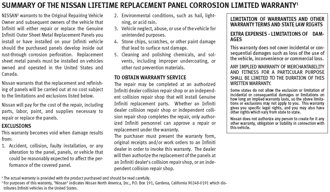

the warranty doesn't really cover much. looks like there's a lot of loop holes for them to worm themselves out of.
pretty sad to already see rust on a car that is just over a year old.

I'm not defending Infiniti, but any car with a chip will develop rust if left un-primed. It's bare metal + elements = rust. The Maranello I worked on this weekend had rust in some of the chips. I'm always on the side of the little guy, but within reason. If car companies starting giving out repaints or body panels to everyone with rust in the chip 75% of the cars on the road would make claims on it. It's a fact of life; same as you're told to change your oil every 5k km you should probably check for chips every few weeks and hit them with primer.
Corrosion warranties are made to protect against a manufacturer defect, which is true of almost all warranties. That means rust from the inside out, or rust which starts to bubble with no chip.
