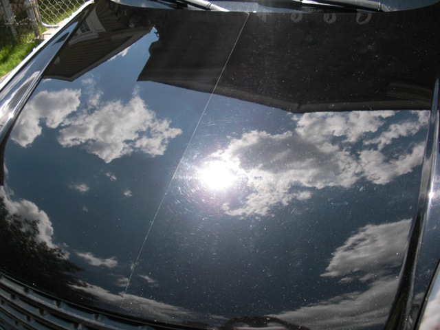

After my PC came in last wednesday!
Attached Thumbnails Detailing question before I order from Eshine.ca-hood.jpg

I'm still learning as I go of course. I started with the hood seeing that it was a nice flat surface with a min amount of curves or grooves that I could potentially burn or whatever. The hood took 3 rounds of PG, 2 rounds of IP and 1 round of MP and 1 light shot of EX.
I do like the way the hood looks. I think alot of my problem is I can't tell when the any of the products are broken down because of my white paint. I can't tell if I'm using too much to too little... I just can't tell ****, and I don't have anyone to help me. I have also been really struggling in trying to get good pictures of what I'm doing. I only have 1 small halogen lamp without a stand....
I just finished PG'ing the drivers side of the car yesterday afternoon. I would love to do 2 more coats of PG and continue like I did for the hood but I'm afraid I'm just not doing it right.
My plan right now is to hit a couple trouble spots with the PG, and just do 1 pass with IP and 1 pass with MP, and just seal it up with EX.
I will do this for the rear as well as the passenger side and then I'll just wait until I can properly consult a professional detailer. What I really need is context around my expectations. I need to know from a professional if it's even possible to remove what I have. That way I won't spend (or WILL spend) days putting multiple passes into my car.
Man I really wish one of you detailing guys lived in calgary. I'm going to have to go onto the classifieds and find someone who's willing to come out for a quick consult...

It's hard to tell from pictures, he may have some RIDs which require sanding, but for the most part I'd say yes, with the right experience he should be able to get that hood 99% corrected. This is his first time with a PC though, and there is a learning curve. I'd say that if you get 75% correction and no haze your first time with a PC you've done a good job. Most people make their paint worse the first time they do it.
