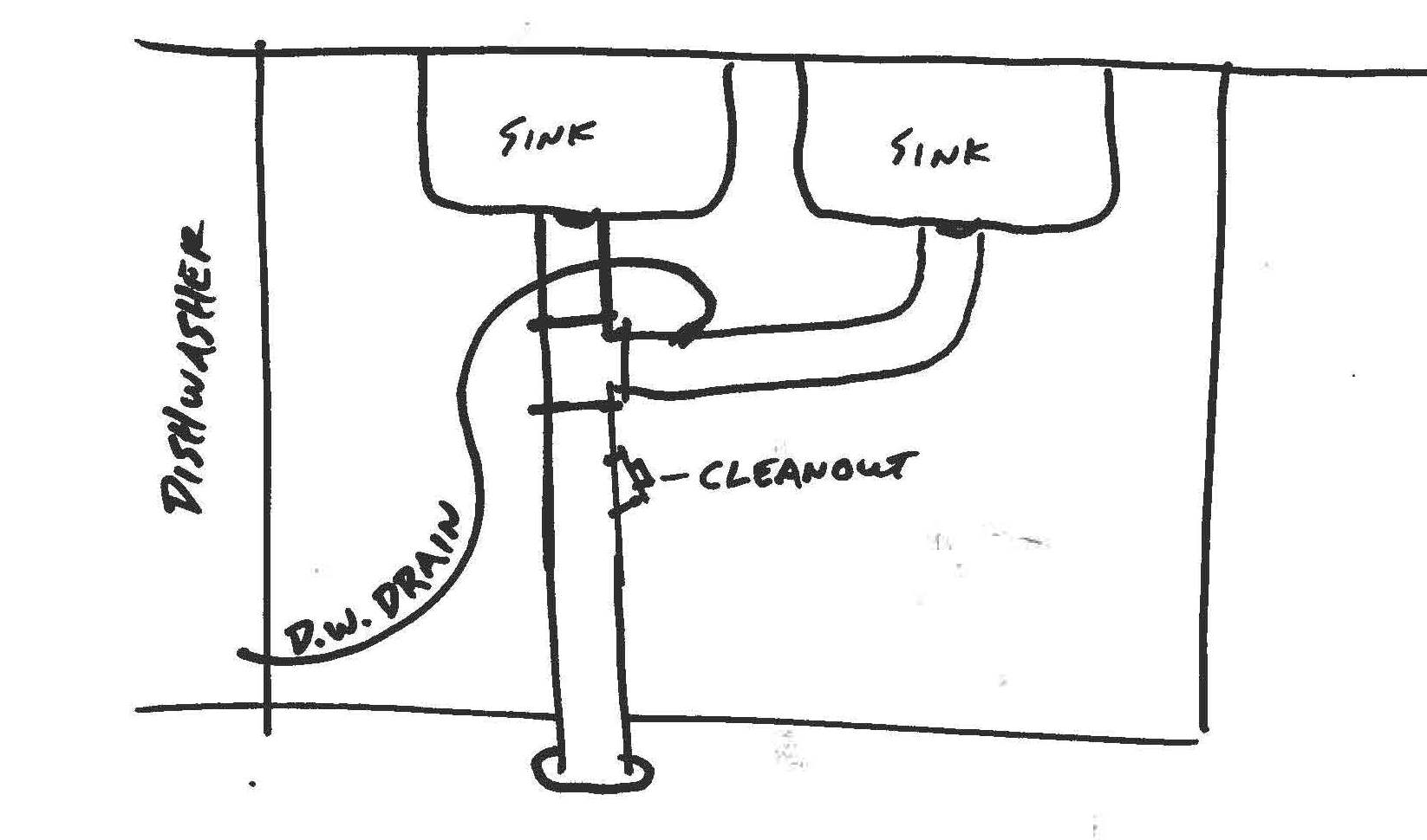

The P-trap missing baffles me too...
Truth be told, I know that bacon grease was poured down the drain a couple of weeks ago and goodness knows what else since or how often. My 13 year old daughter is cooking for herself now or should I say learning to cook. She didn't realize you don't pour that stuff down a drain. (you would think she noticed me pouring grease into old soup cans all these years, oh well)
She feels bad enough about it after seeing me battling with it for more than 5 hours last night to no avail. I can't get angry with her because she honestly didn't know any better. Live and learn.
Attachment 110792

Is there "trap" for cleanout where the entire house will evacuate to the sewer system? The plumber might start from that end instead of from the trap at the sink since you were able to fish a metal line down and not hit anything.
Did you use a proper plumbing "snake"?
Who lived in the house prior to you? Did they have children?
I've found many various items where I work that kids( and adults) have put down the drain....spoons, popsicle sticks, knives, etc...

most p-traps usually need to be replaced once water flow slows down... simply because of all the gunk that goes down there. they are also supposed to protect u from all the sewage gas coming up the other direction of the pipe. p-traps used to be glued onto the rest of the piping ... these days they're usually just held on by a couple of lock nuts which makes taking them apart a cinch.
looks like someone took a short-cut for whatever reason when they installed that sink. u should have a quick look at all the other sinks in the home and make sure they have proper p-traps installed. good luck with the clog.

Fixed it myself
Last night I borrowed a buddies manual 1/2in x 15ft drain auger. They cost about $15 bucks at the hardware store. It worked like a charm. I felt it bite into the clog about 3ft below the cleanout. Once the 'snake' started to bind up a little I pulled it back and voilà. Lets just say it was a little messy and disgusting but the clog was gone. The whole thing took less than 10min. I wish I had have done this the night before instead of the plunger / chemical combo for 5 hours. lol

good to hear Paul.
I'm still curious about the P-trap though.
As Roman mentioned, there has to be a trap somewhere or you will get sewage gas.
It can be deadly ...literally.
