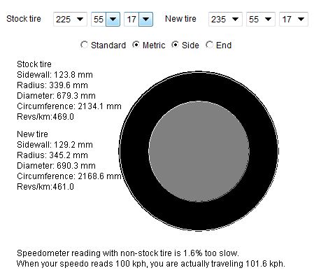

As some of you know, I have an X. The factory tire is 225/55 R17 95V.
Is it safe to put a set of 235/55 R17 tires on the factory X wheels.
Also, can I put an H rated tire on. I don't see myself exceeding 210 km/h (130mph)
I don't care about the speedometer accuracy too much. I am one of the lucky ones. My speedometer is out by 4-8km/h depending on how fast I am driving. It always has been. e.g When my speedometer reads 117km/h I am actually travelling 110km/h
Thanks

Yes, a 235/55/17 will work. I would suggest a V-Rated tire. Handling will suffer when dropping down to an H-Rated tire even if you're not reaching the 130mph limit of the tire.

As grant said, don't NEED anything higher than an H, but you'll notice it compared to something squishier.
