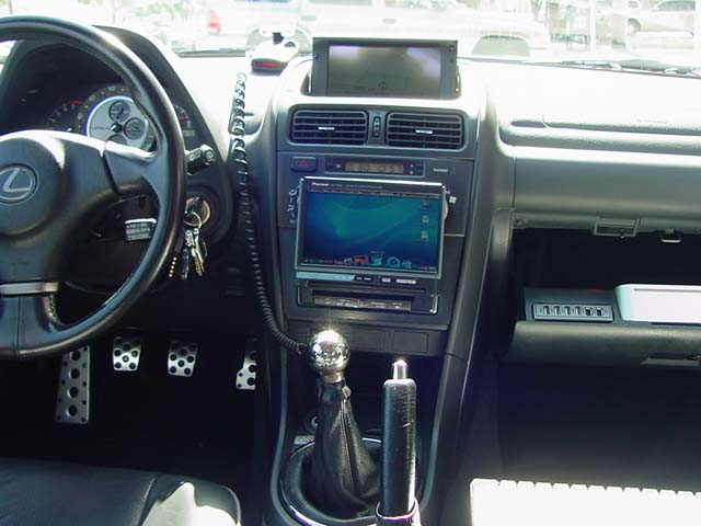

Iam very interested in this... ahve you ever thought about mac.
Ambitious, ultra-clean carputer/nav replacement-mac-dash.jpg
Ambitious, ultra-clean carputer/nav replacement-mac-glovebox.jpg
Ambitious, ultra-clean carputer/nav replacement-small.jpg

mac mini is pretty standard for carputer.
www.mp3car.com is your best resource

I'd love to see how this comes out! I'm interested in carpcs more than anything. I've fabbed so many screens into dashes, it would be nice to put one in that does something more than play video. I plan on having a computer setup in my next vehicle using Centrafuse and a Mac Mini...
