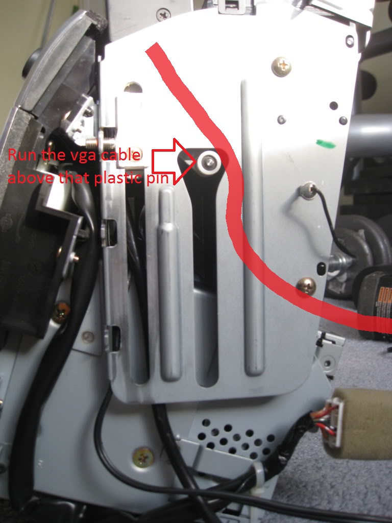

Thanks that actually helps a lot. My only question now is whether or not your screen actually moves. My vga cable seems impossibly thick to run alongside that track.
Old Jul 9, 2010 | 12:54 AM
  #50
Dracov's Avatar
Posts: 56
Yea, my screen moves up and down.
Heres the pic that hopefully will help you position the cable.
Attached Thumbnails Dracov's CarPC. Stock Navi replacement DIY. Status: in Progress-vgacable.jpg

Reading back I came off as sort of a jackass, that wasn't the intention. When I read Plastic tab i though the one to the left of that in the picture.
Thanks a lot! I will rework it tomorrow and chime back in.

Got it work! Thanks a lot bro. I basically rethought the way I was routing it and boom! worked fine

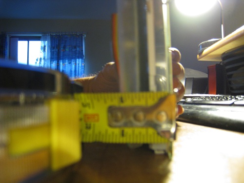

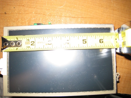

really appreciate the help...! especially with the PIC of the stock screen... that is strange, I will take a pic later tonight of the stock screen I have, comparing the 03 04 and the 05-07 i bought by mistake... with a measuring tape... the pic you show clearly shows 7inch screen... my pop out mechanism for the 03 04 looks identical to yours....

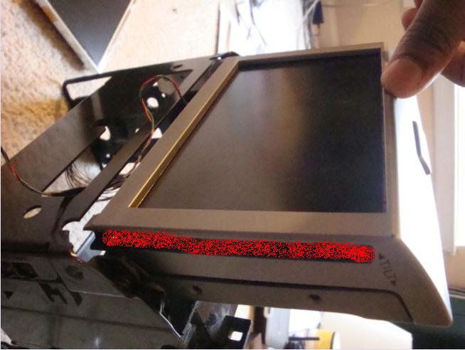

Basically, with the unit I am trying to fit, Lilliput EBY701, I find I will have to cut out the following (in red) to get it to fit as per the attached jpeg... Did you have to do any similar cutting?
Attached Thumbnails Dracov's CarPC. Stock Navi replacement DIY. Status: in Progress-screen_red.jpg

Yea I did some dremeling when I had tried to put in the other 7" screen. The screen not installed is an eBay screen from china or japan that I got maybe 8 years back. It's made by Super. The screen that I have in there now is from a portable toshiba DVD payer. Only trouble I'm having is with mother board placement. My final plans is to have this 7" screen and an 8" touch screen under it.. I may have to go with 2 touchscreens if the mother boards run smaller
