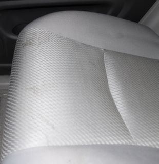

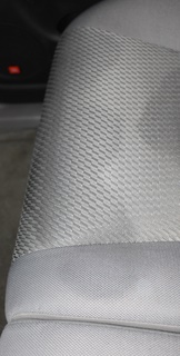

I did use the Meguiars product you recommended and the results were perfect. Thanks for the help. I attached pictures of before and right after while it was still wet. It dried up fine and did not leave any marks. The one bad part about using a brush on this fabric is that it tends to rough up the fabric a little, but I suppose that is the trade-off. Next up, I will clean the carpets as they look pretty bad right now.
Thanks again!
I'd go with some Meguiar's All Purpose Cleaner Plus and a good scrub carpet brush that you can find locally. Work it at a 6:1 ratio or so and you can increase the power as needed.
I'd follow this routine:
Brush
Vacuum
Spray the APC and let dwell for a couple minutes
Scrub to agitate stains
Wipe / Vacuum
Repeat as needed
Something else you can do is keep a pot / bucket / spray bottle of very hot water close by as this can help aid in breaking up stubborn stains.
Most of interior cleaning is elbow grease, a good APC like the Meg's should be all you need.
Keep us posted how it turns out.[/QUOTE]
Attached Thumbnails Ask a Professional Detailer...-2010_11_26_000001090.jpg   Ask a Professional Detailer...-2010_11_26_000001091.jpg   Ask a Professional Detailer...-2010_11_26_000001092.jpg   Ask a Professional Detailer...-2010_11_26_000001093.jpg
Thanks again!
Glad to hear everything worked out for you. Having different firmness brushes in the future couldn't hurt if you noticed it started pulling with the one brush you used. Softer brushes usually won't rough it up as much but also isn't as effective at cleaning either.
Carpets should come out great too using that same technique. Thanks for the followup!
