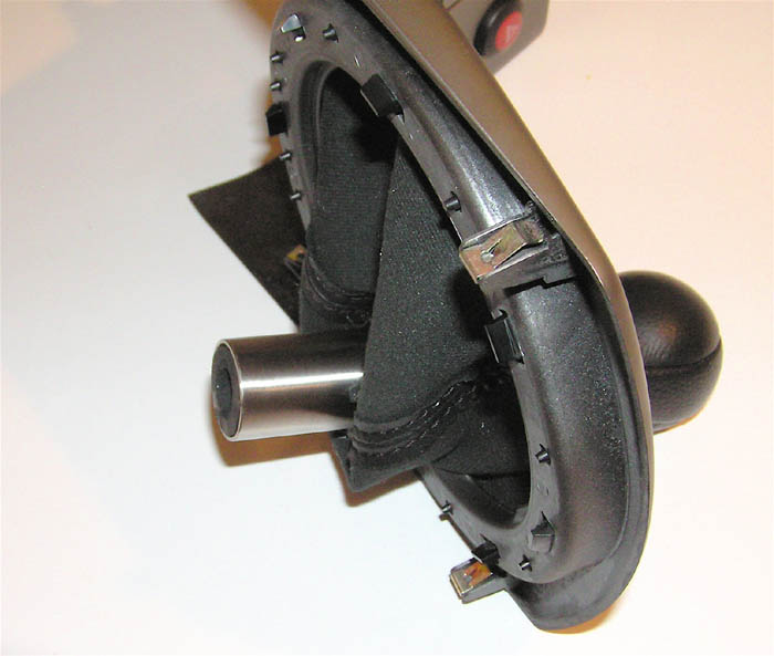

I had one of the first Rogue Engineering Short Shifters when they first came out a year or two ago. The first one I had was maybe their prototype. It came apart in the middle after a month or so due to twisting the Shifter **** on tight. I called R.E Engineering and they were very apologetic. They NEXT DAY'd their new improved Short Shifter with a bolt though the middle two halfs along with the original epoxy to hold it all together. Now that's Customer Service. No problems since!
The only problem I had on install was getting the lower(under car)rubber boot back on. Finally...I had my Wife hold the shifter down from inside the car, then I was able to press the lower boot on...
Pic 1 & 2: the original R.E.SS after it separated.
Pic 3: Top shifter is second improved R.E.shifter they sent me(notice bolt through the middle), Bottom shifter is the stock one...
Attached Thumbnails Rogue Engineering Short Shifter Install-reshifter2.jpg   Rogue Engineering Short Shifter Install-reshifter3.jpg   Rogue Engineering Short Shifter Install-reshifter1.jpg   Rogue Engineering Short Shifter Install-nightlights5.jpg

I'd say the hardest part about this install was removing the shift ****. It took me like 7 minutes worth of twisting to ge tit off.
