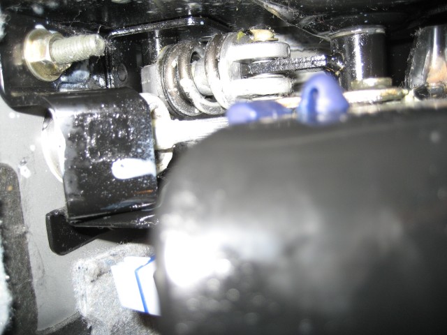

Even though the click is much less noticeable now, it's still there. I took some photos of the clutch pedal area and I think I will spray some additional white lithium grease and clean up some of the mess the dealer made...

Originally Posted by SPice
I readjusted the ACSD as described above; did not fix the clicking, but did eliminate a lot of noisy play when the clutch pedal is at the top. HOWEVER, as mentioned in another post, I rotated the spring (while the pedal was depressed), and the clicking is GONE.
THANKS!!!

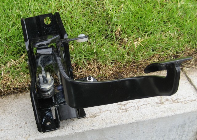

So with your foot off the pedal, you rotate the spring? Is it the spring pictured here? :

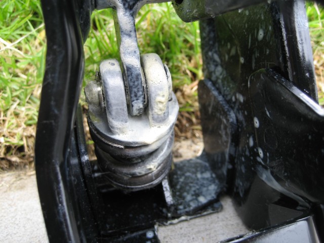

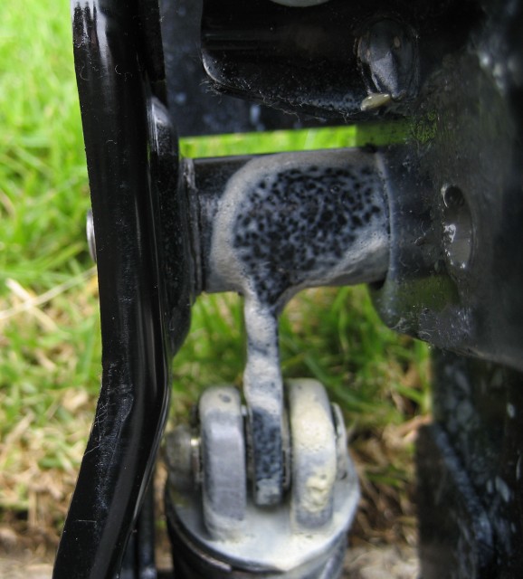

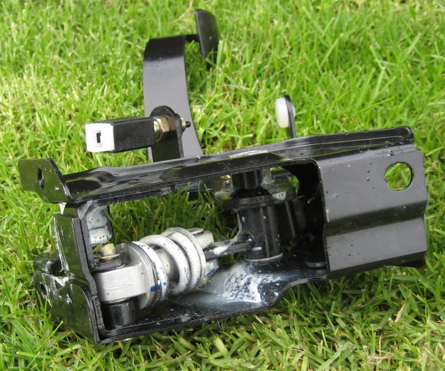

Here are some pics of the old assembly:

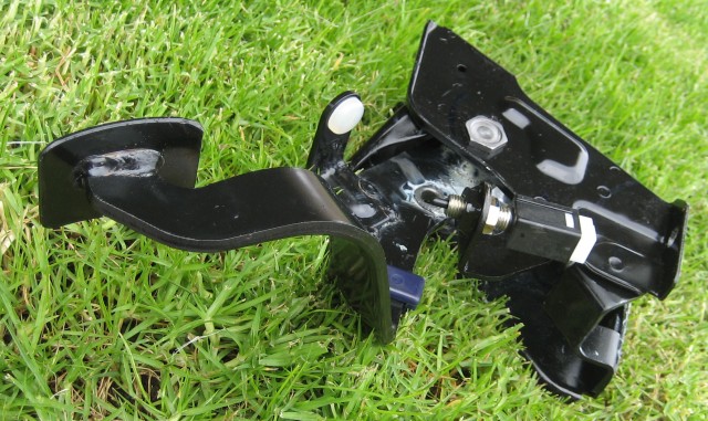

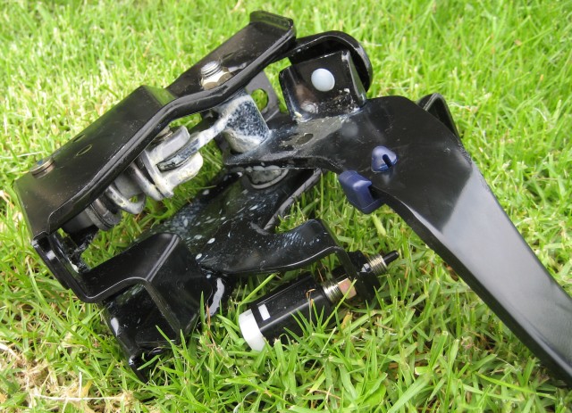

and here are some more pics of it:
