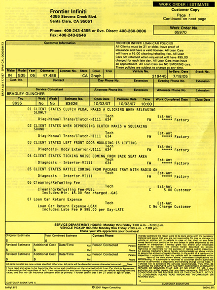

I took it in this morning to have the clicking looked at, here's the work order:
I will keep you guys updated...
