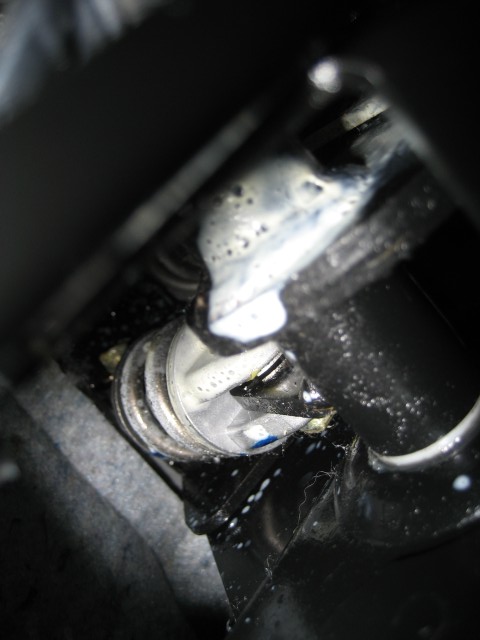

Hope this is the end-all post since this is how I fixed mine. After multiple attempts of rotating the cotter pin/dowel that is easily accessible, the noise was still there. I ended up putting my finger on the spring (just slightly since there's moving parts) and felt that was where the popping was prominent. When you press the clutch pedal in, the spring tension is released, extending the spring. I pushed up (towards the steering column) on the spring and it shifted up slightly. Release pedal and.... NO MORE POPPING FOR SIX DAYS SO FAR!!!

I had the same problem. Tried Bigd2k6's fix above and now i'm pop-free for 3 days. Hope it lasts.

save a trip to the dealer and do this yourself. it literally takes about 1 minute to re-seat the spring and the best part is no tools are required.
