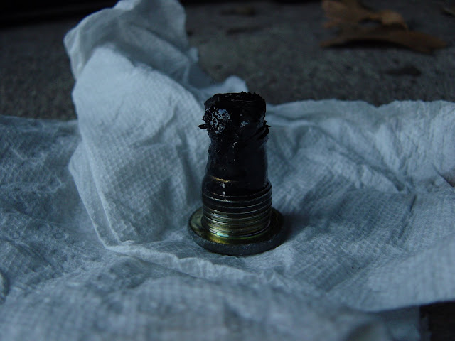

Ended up with Mobile 1 75w90 gear oil and Matic D for transfer case.
Bought 3 quarts of Mobile 1. So far, I've used about a little over 1.25 quarts for the rear differential.
Just like everyone else, the drain plug on the differential collected alot of gunk and the drained fluids STINK.
