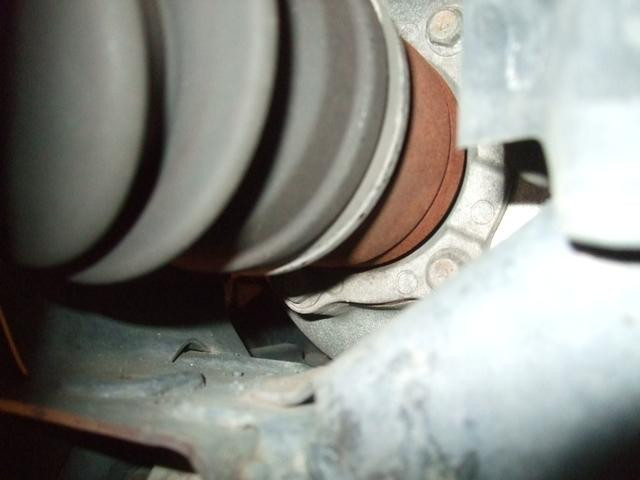

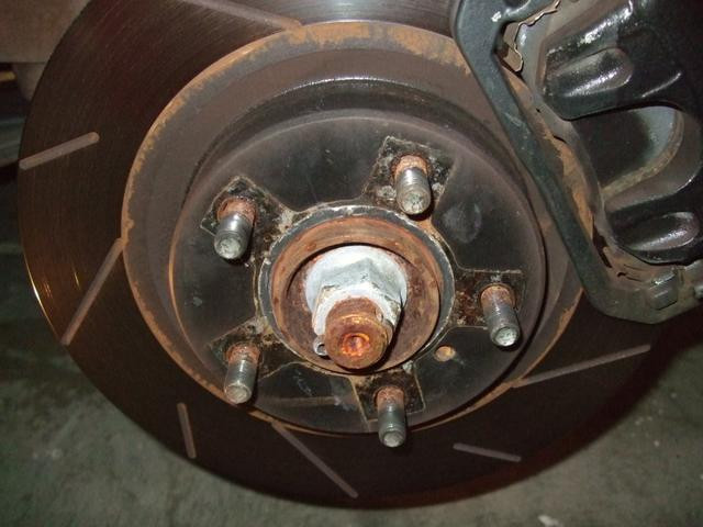

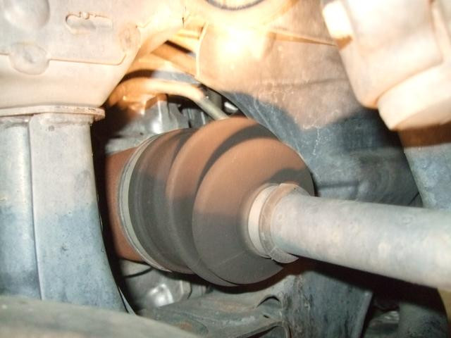

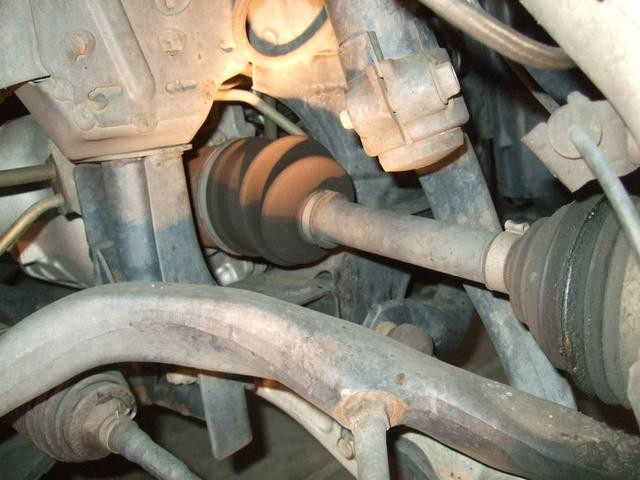

Did my best to snap pics of areas that i think I'll be working in including. I still have the car jacked up so let me know if you need any better shots or diff angles.

these pics wont really help, do me a favor take a pic of like the whole wheel well from a short distance so i can point out the nuts that you have to take off

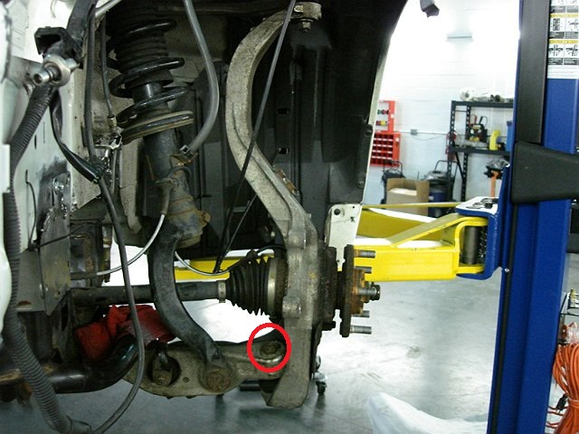

Ill do my best to explain it from memory:
1. Jack up and take off wheel
2.Remove axle nut
3.Remove 2 bolts holding caliper on
4.Remove rotor
5.Look on the knucle somewhere there should be a nut facing upwards(circled red in pic #1). Remove this nut and if i remember correctly you should be able to manuver that end of the axle out while rotating the knuckle.
6.If the knuckle doesnt rotate yet then remove the nut thats connected to the upper control arm.
7. Once you get the axle out of the wheel bearing end, you then have to try and "pop" the other end out of the front diff. For this i used 2 pry bars/ screwdrivers and used them at the same time to pop it out. Takes some force and is kind of a PITA but it will come out
And thats about all. I know its not perfect but its off the top of my head, so i cant remeber everything without having it in front of me

^ Rotor removal isn't always needed. I guess it helps but you can often times leave them on.
the picture looks really easy to get to, me having done like 8 suspension pulls now.

Hopefully you can get it done with that lil explaination.
Anyways as you see the the picture you should be able to pry right where the arrow it pointed, there should be a space there. Just try popping the axle, you will know when its out then you just grab the axle in your hand and the whole assembly will come right out
Again these directions are off my head, if your stuck anywhere just let me know
