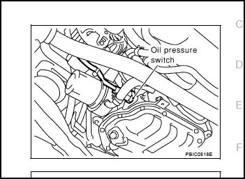

stoopid question but where is the oil sensor located?? (please dont say in the oil pan)..

Next to the Oil Filter....and it is sensing pressure not level.

take the sensor off and hook up a pressure gauge to make sure your oil psi is good. other then that, if it is good, just put a new sensor in. its right next to the oil filter.
