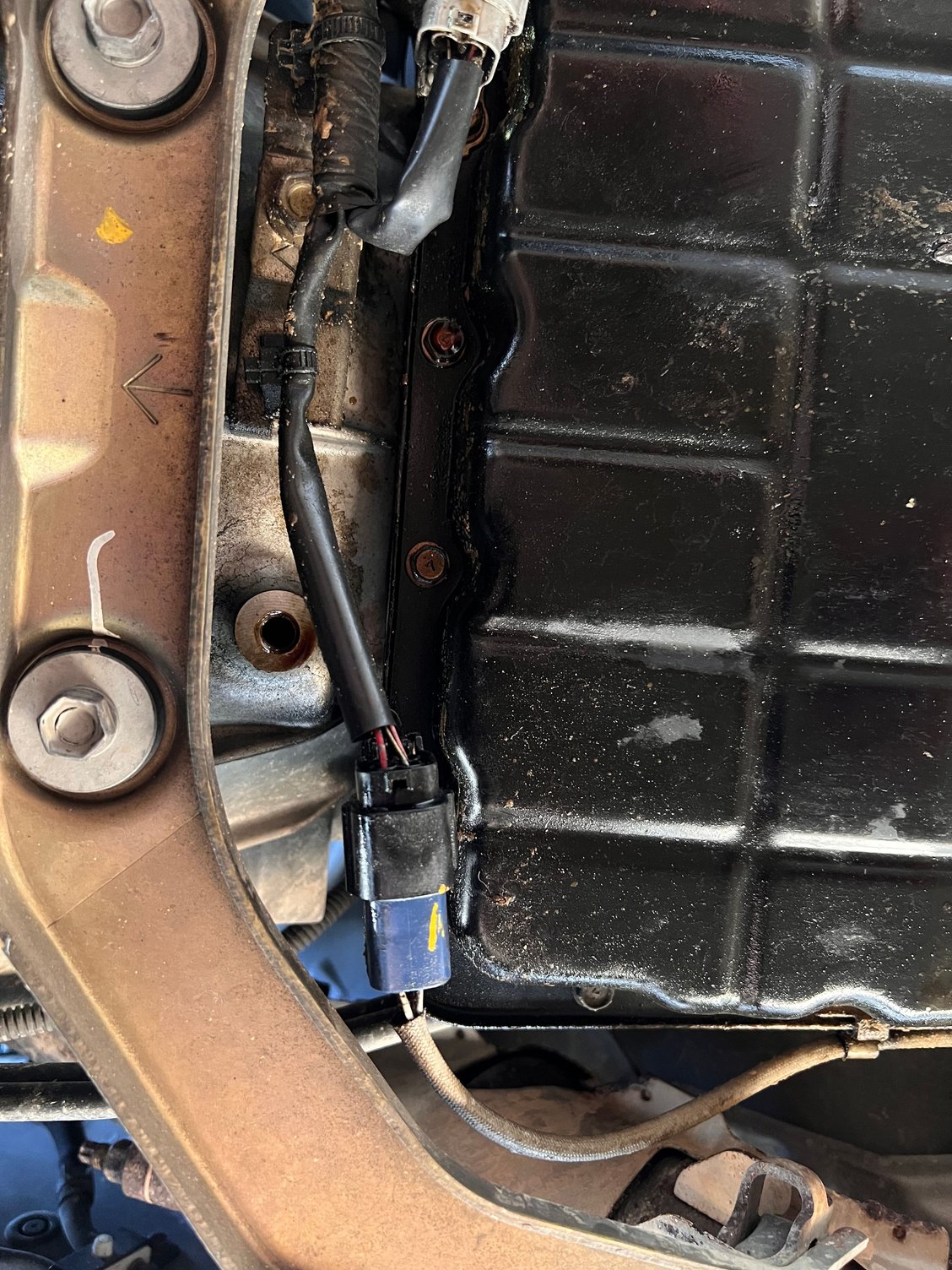

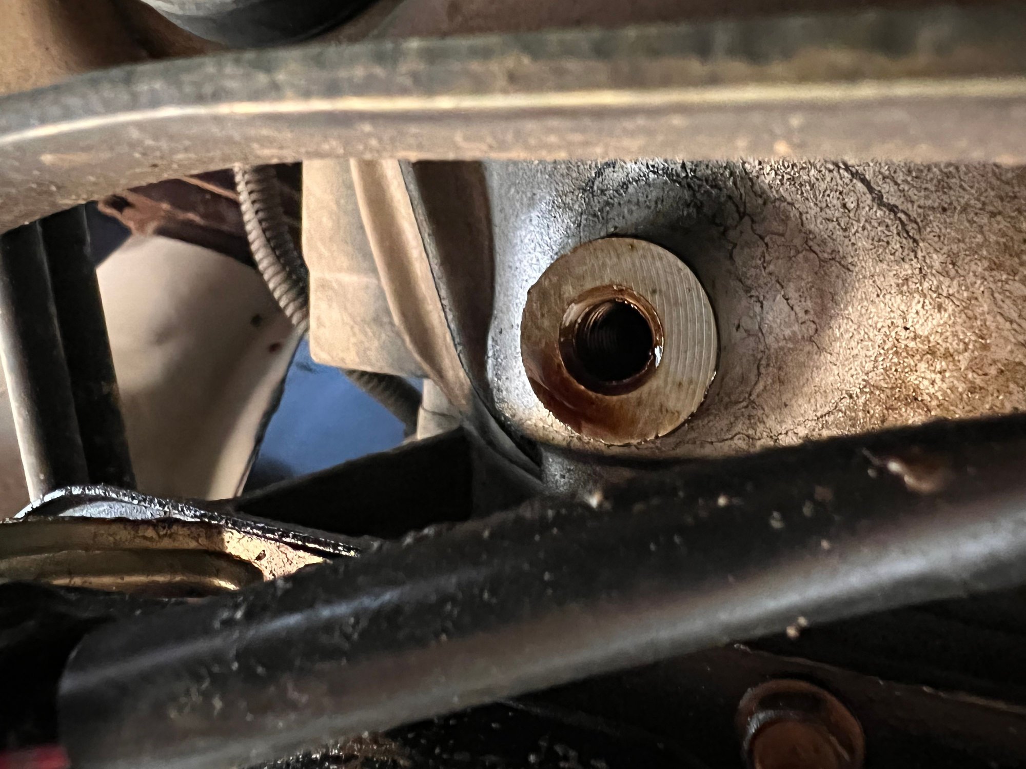

Hmmm
Should there be a plug in this hole? Looks like maybe AT drain plug, but fluid level looks fine, if not a little high.
