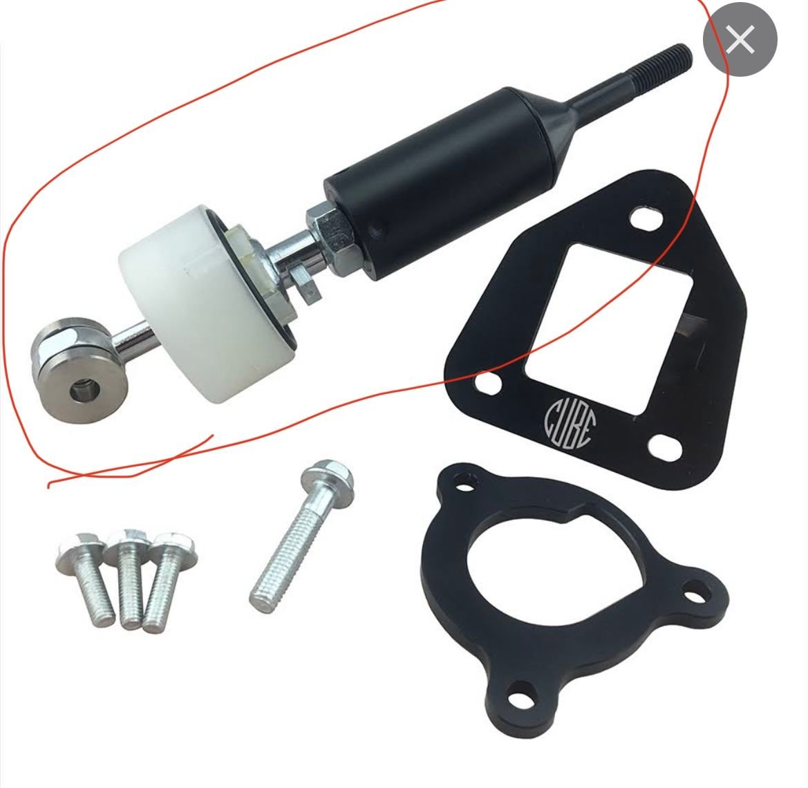

So I tried changing the pivot ball but that didn’t do anything. My shift linkage is bent do you think that could be the problem, if not then i think imma have to get a new trans

Start with the shifter, maybe consider an upgraded one like the B&M, or the stock one from your CD009.
that was next step, I was looking into a coolerworx shifter. My boy got one and I really liked the feel of it when shifting. I’ve also heard that I could possibly be my clutch since it goes into gear while the car is off but not on
