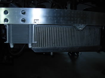

Here's a picture of where I mounted the oil cooler. I wasn't able to mount it the way I wanted to, so here was my second choice. Working around the intercooler makes options tough. It is mounted at an angle to hopefully catch air coming in through our small grill and direct it over the majority of the cooler.

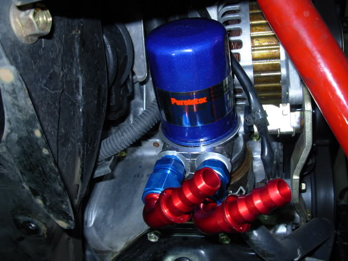

Here's a picture of the Mocal sandwich plate with the necessary fittings.

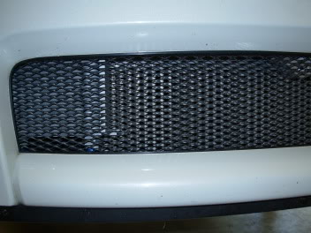

The finished product. 90% of the oil cooler gets direct airflow through the grill. Earls oil cooler installed using (2) 90 degree fittings. -10an Aeroquip hose connected. Although you don't have to use hose clamps on socketless hose, I did anyways since I had them laying around. Call it peace of mind.

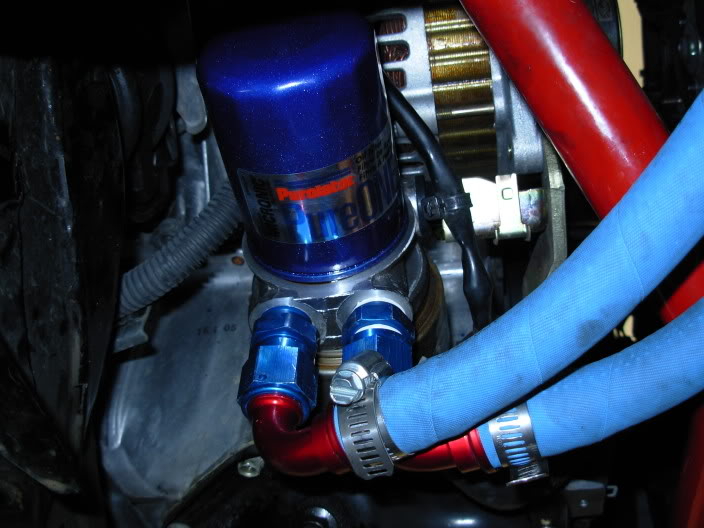

Mocal sandwhich plate with hose connected. Once again I added hose clamps. I routed both hoses through the plastic shield near the winshield wiper fluid container.
