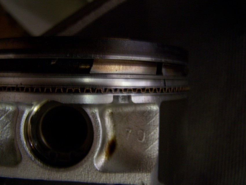

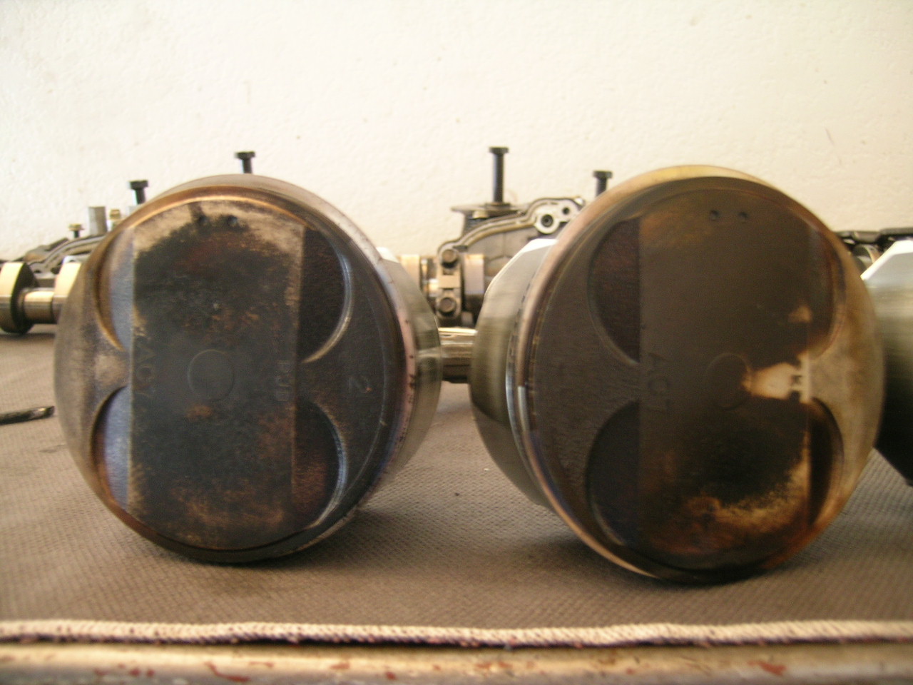

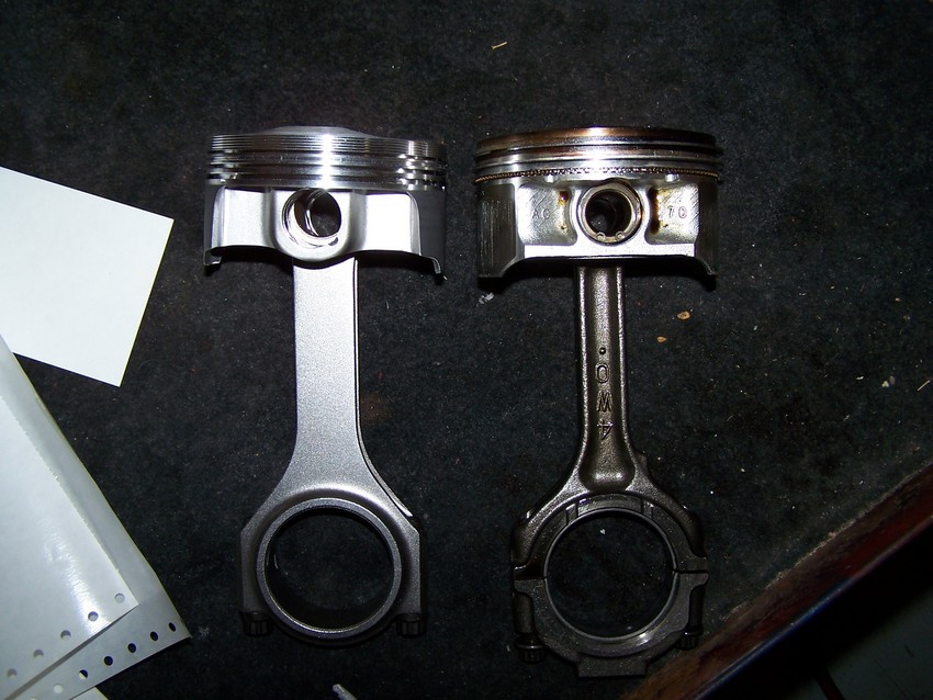

The Revups pistons, rings, and lands are junk as far as I am concerned. I opted to do the tear down and rebuild myself, and this is what I was rewarded with. Keep in mind at the time of the pictures it had a whole 16K on it. Well EVERY ring land was either fractured or broke. A lot of oil build up on the top of every piston. Just not what I really expected to see...well you can see the difference with what I replaced it with and so far not a drop of oil burned! I think this is the problem. Thought the pictures would be good for you to see......
I work at infiniti and myself and the technicians, shop foreman, and service manager are well aware of this issue and how to fix it but it is not up to us. We have to follow infiniti "guideline" for their warranty repairs. I actually commented on this a while back when I first started on this forum and was told I was wrong that it was a fault in the heads and blah blah blah. But glad to see someone opened up a motor and actually noticed the issue. I come from a different manufacturer where a car making 600 plus horsepower didnt burn up as much oil as the g35s. But nissan is "working" on a solution weve replaced 2 engines per techline and have advised them that it will not do anything and advised the customer that it will still have the issue. Only to be told by techline that it will take care of the prob and have the car back in 1 month with 500 miles and still burn oil. Maybe one day they will pay a bit more attention to the actual problem and rectify it. But until then we are at their mercy at the dealer on how to go about handling the cars with oil consumption issues.
